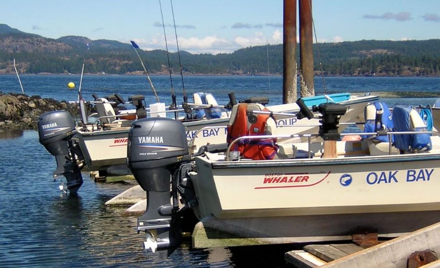

Nick--welcome to the forum. I assume your boat is similar to the boats used by professional guides at April Point Lodge. When I visited there in 2003 all the boats had Yamaha tiller engines. You might visit April Point Lodge and chat with a guide or a mechanic there to get their informed opinion on the Yamaha engine.
Fig. 1. Yamaha engines on 17-foot Boston Whaler boats at April Point Lodge in 2003. Photo by the author.

My boat is exactly like those [boats shown above in Figure 1].
