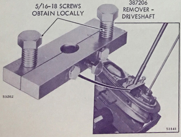

My upper bearing carrier extraction tool came today. It is an OMC # 387206 and it clamps around the driveshaft to press it up and out, taking the bearing carrier with it. But the FSM shows a set screw that secures to the water pump impeller flat on the driveshaft. This tool does not have that set screw even though it is the exact tool part number. Maybe it is a superseded model that clamps the shaft tight enough to get it out. I think I will take my drill press and drill a hole and tap it for the set screw. That way even if it slips it can't get past the impeller flat and will raise them up.
Fig. 1. OMC #387206 Driveshaft removal tool

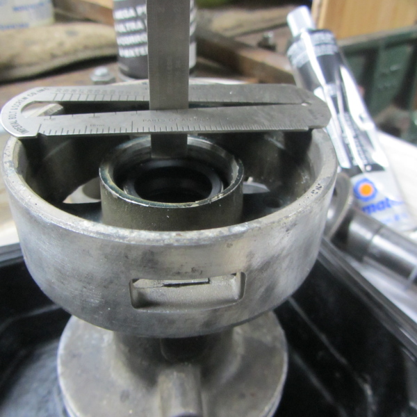

Today I used the driveshaft removal tool on the freshwater gearcase. I drilled and tapped the tool for a 3/8" set screw like the FSM says should be there. It clamps around the driveshaft.

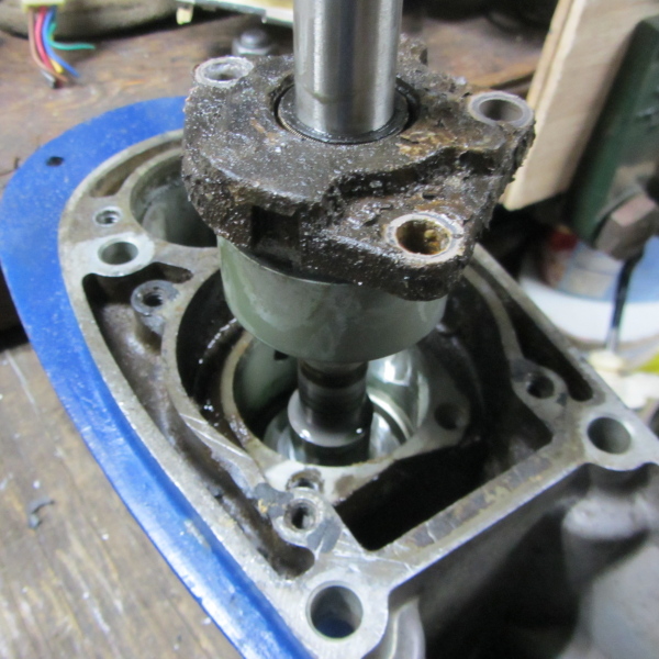

I pulled the driveshaft, the upper bearing, and the seal carrier up and out while disengaging the pinion nut from the driveshaft.
The pinion nut is a press fit and this tool easily popped it right off.
Once the driveshaft is out the forward gear and bearing and shims can be removed. I tie-wrapped both the forward and reverse gears to their respective bearings and shims so they don't get mixed up.
Then I removed the leaky seals that started this whole project. I used a common automotive seal pry tool to carefully get all the seals out.
Now the gearcase and all the parts are soaking in #2 oil, an excellent non-flammable solvent.
Fig. 2. Driveshaft removal tool
Fig. 3. Bearing and seal carrier removed.

I noticed in Figure 2 that you added the set screw that was not on the original tool as seen in Figure 1. I would have thought that the circumferential pressure of two halves of the tool pressing onto the drive shaft would have been sufficient to keep it in place when applying upward pressure.
Did the set screw leave a mark on the drive shaft?
Did the two steel bars that are shown in Figure 2 placed under the tool come with the tool as purchased? They look like a good method to prevent the upward-lifting screws on the tool from damaging the workpiece.
ASIDE: nice photography in Figures 2 and 3.

I drilled and tapped the tool for the set screw because the tool described in the [factory service manual] had one. I did that because on my saltwater gearcase that bearing carrier would not come out and needed to be chiseled apart. I was expecting the worst but it turned out this freshwater gearcase was not corroded at all. The carrier extracted easily as it should.
The set screw did not damage the shaft. That spot [where the set screw bears against is] where the pump impeller wedge sits.
Fig. 4. OMC factory 387206 driveshaft extractor tool with set screw
The factory tool required a plate that sat on the gearcase to protect it as mentioned. None of the factory tools I found included that plate. The plate is a separate part number and I could not find one.
Fig. 5. OMC 325867 extractor tool backing plate to protect gearcase
The aftermarket tool made by Precision Tools did include it. I had a similar plate but it would have needed the hole enlarged. I also had the two stainless bars handy to protect the gearcase and they worked just fine.

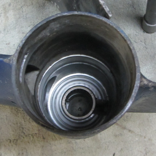

I finished de-greasing the parts from the freshwater gearcase. At the 20-degrees-F air temperature yesterday, there is very slow evaporation, thus minimal fumes. I had let them soak for a week in number two oil--the same as Diesel fuel. The parts came out very clean. I left the pinion and forward bearings in place as they were still serviceable.
Fig. 10. All the parts from the 48hp gearcase
Fig. 11. The 48SPL lower gearcase and forward bearings
FIg. 12. The 48SPL upper bearing and driveshaft cavity. Pinion bearing at bottom.

I put the forward gear, thrust bearing, and spacer into the gearcase. The OMC roller bearing grease holds the parts in place while you work.
Next, the driveshaft bearing carrier goes on the driveshaft and the whole assembly is placed into the gear case. Wrap some masking tape around the driveshaft splines so as not to cut your new seals. Don't push the carrier all the way into place yet. At the same time you must place the pinion gear inside the gearcase and on to the end of the driveshaft.
I found I had to lift the driveshaft up and out of the way to get the pinion gear past it. Some gearcase oil goes on the threads and then the pinion nut gets torqued on. Once that is done then you can push the bearing carrier all the way down into the gearcase and bolt it in place. To get the carrier all the way in was difficult, but tightening the bolts finished the job.
I used some Ultra Black on the carrier to gearcase mating surfaces and anti-seize on the bolt threads. Do NOT use sealer on the carrier sides or it will never come out again.

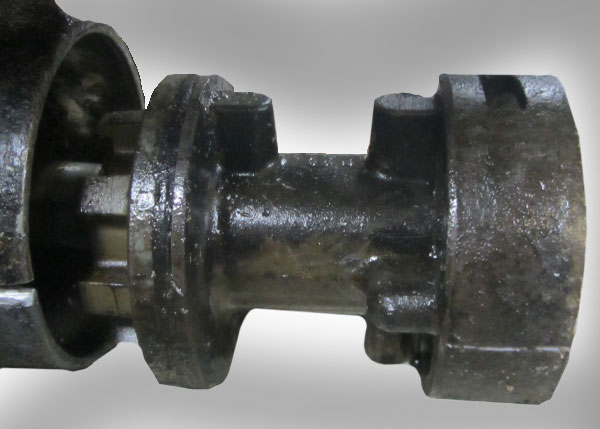

Next. place the shifter rod O-rings on the shift rod cover, then the O-ring and bushing onto cover, then sliding them all onto the shifter rod. Grease the O-rings with OMC Triple Guard grease and use Adhesive M or 3M 847 to seal the O-ring bushing to the cover.
Screw the shifter lever onto the end of the shifter rod. Set aside.
Fig. 23. Soft-focus on shifter lever engaged to shifter cradle on end of propeller shaft, outside of the gear case to illustrate the eventual assembled position.
Now we can insert the propeller shaft into the gear case with the shift cradle in place. The trick is to place the shifter cradle onto the end of the shifter dog shaft, using some OMC roller bearing grease to hold it in place. This is key, or it will slip off and it will never stay in place.
What is being done is inserting the propeller shaft, with the cradle attached, into the gear case--all the way in. You will see the cradle from above looking into the shifter rod cavity. Then you drop the shifter rod with the shifter lever down into the shifter cavity and the lever must engage the shifter cradle. This is critical to get right
Once you are sure the parts are assembled properly, you screw the shift lever pivot screw into the side of the gearcase being sure to insert it through the holes in the shift lever. Use some Lok-tite on the threads and seal the screw O-ring. If you did it right, now the prop shaft can not be removed and you can shift the clutch dog by hand using the shifter rod.

While waiting for the Ultra Black to cure I turned my attention to the frozen gear case.
To pull out the bearing carried I tried every trick I knew--they all failed. I used my Dremel-tool cutting disc to cut open the gear case housing at the bearing carrier. I used the OMC carrier puller tool to put as much pressure as I dared on the carrier. The OMC carrier puller tool is similar to a steering wheel puller, but the plate is much thicker and stronger. I found some 9-inch-long grade-8 1/4-20 bolts to fit the 40-48-50-HP engines carrier retainer bolt holes.
Fig. 30. The OMC carrier puller in pulling position. Dremel tool with cutting disc used to cut the housing.
Fig. 31. Closeup of the housing cut to relieve pressure on the carrier.
While the tool applied tremendous pulling pressure on the carrier. I carefully cut along the side of the housing. Just as I was getting past the outer carrier flange, I heard a loud pop and the carrier broke loose from the housing. After that it was easy to pull out the rest of the gear case internals with the OMC puller.
Fig. 32. The intact bearing carrier finally out of the housing.
I found no corrosion at the O-ring flange. The inside of the housing where the outer flange sits was severely corroded. That is why it was stuck so solidly.
Now that I salvaged the bearing carrier without harming it I can take the rest of the parts from this case and use them to re-build the spare gearcase.

I found that the bearing in the carrier is the same as the pinion bearing. So the same bearing tool can be used to install the inner carrier seal.
Fig. 39. Inner and outer seals back-to-back.
The smaller part of the tool fits the carrier roller bearing and guides the seal straight in.
The OEM double type seal use two seals- one with the lip facing the oil side of the gearcase. The other lip facing the water outside.
I applied the Ultra Black sealer to the inner seal and drove it in with the bearing tool. Then I partially drove in the outer seal and thought that since the lip faces out and the tool is not an exact fit it might hurt it.
I found an 11/16-inch impact socket fit better, so I used that to drive the outer seal in the rest of the way.
Fig. 40. 11/16-inch impact socket to drive in the outer seal.
The seals fit back-to-back in the carrier so if the inner is flush then the outer will also be flush.
The cavity between the seal lips is filled with OMC Triple Guard grease.
Then I placed the O-ring dry on the carrier and inserted it by hand into the gearcase with no sealer. I then lightly pressurized the case. The seals were so good that the air pressure forced the carrier out of the gearcase. It moved out until the O-ring went past the lip where it then leaked air. That is what I was looking for.
Now I can install the carrier with sealer and see if it holds pressure like it should.
