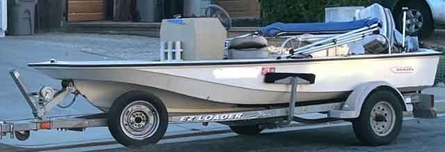

Postby OGSW20 » Mon Mar 14, 2022 11:57 pm
Fig. 1. A Red Dot hull 15-footer.

Re: 1978 15-footer Red Dot Restoration
Postby conch » Fri Mar 18, 2022 9:07 am
Can you post up a picture of the red dots on the sides of your hull for us all to see?
Postby jimh » Tue Mar 22, 2022 8:43 pm
The Red Dot is usually part of the gel coat layer. The rest of the logo is a decal. That's why they appear in different condition.
