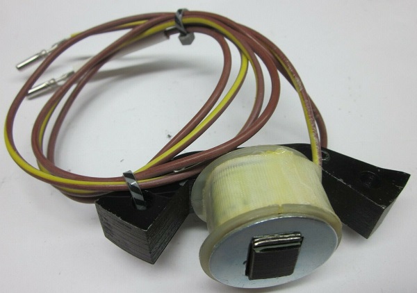

[On an older Evinrude outboard engine the permanent magnet alternator (PMA) stator assembly has a peculiar coil called a] "charge coil" that has a stainless steel [later found to be magnetic steel] faceplate attached to the front of the coil assembly as shown below. [Some other Evinrude outboard engine permanent magnet alternators have a] ''charge coil" that does not have the face plate.
Fig. 1. A Charge Coil with stainless steel faceplate.
What is the purpose of the face plate?
On my outboard engine, the face plate came loose and was causing damage to the coils and flywheel. I found the faceplate jammed against the flywheel magnet.
If my engine came with a stainless steel faceplate attached to the front of the charge coil, can I use a charge coil without a stainless steel face place?

I do not know the intended purpose of the metal face plate on the charge coil, however I will make a guess.
There are two realms in which the purpose may lay:
  • mechanical
  • electro-magnetical
Considering the mechanical realm, the purpose of stainless steel faceplate for the charge coil may be to protect the pole or laminate structure from damage if there is any debris in the the gap between the coil and the rotating flywheel.
Considering the electromagnetic realm, the purpose of the stainless steel faceplate for the charge coil may be to reduce or increase the influence of passing magnets to exert magnetic force onto the pole to a smaller area, based on the assumption that stainless steel is a martensite steel of type 316, a steel with very low magnetic permeability.
I really don't have a great understanding of magnetism and steels. Perhaps the stainless steel faceplate helps to focus the magnetic field onto the coil.
If you could explain further about the FUNCTION of the coil you refer to as "the charge coil", it would help me better understand its purpose.
Test the faceplate with a magnet to see if the steel can be held by a magnet. I think you will find it cannot. This would be important. If the plate were magnetic steel, the passing magnets in the flywheel would tend to pull it way from the coil and onto the flywheel.

I tested the shards with a magnet and while at first they appeared to be stainless steel, they are not. In fact they are extremely magnetic like mild steel.
Would [the face plate being made of ferromagnetic steel] help to expand the exit-able [perhaps excitable] area of the laminated core?
Underneath the steel plate is a plastic plate of the same size. The function of the Charge Coil is to produce 200 to 300 Volts-AC when the flywheel magnet passes by. That voltage is then sent to the CDI unit.
A trigger coil [sensor] is then excited by the flywheel to let the CDI know when to charge the ignition coils to fire the spark plugs.
OMC changed up the parts year by year for some reason. My 1993 48SPL has the trigger and lighting coils all in one unit. The Charge Coil is separate. The 1996 48SPL has separate charge, trigger, and lighting coils. My 1985 30hp has the same ignition parts as the 1996 48SPL but no plate on the Charge Coil.

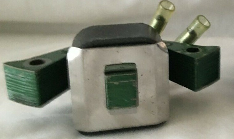

Green Bay Propeller sent me the CDI-brand replacement coil; they sent just the coil, not the coil and its laminated core. The the original laminated core must be used with the new coil winding assembly.
CDI calls the metal face plate a SHUNT PLATE. If the coil being replaced used a shunt plate, the replacement coil MUST be installed with the included shunt plate. If the coil being replaced did not have a shunt plate, the instruction emphasize to NOT install a shunt plate on the new coil. Use of the shunt plate seems to be application=specific.
If the installation has been done properly, the new coil, laminated core, and shunt plate should appear as seen below.
Fig. 2. The original laminated core with a new CDI coil with Shunt Plate installed.
CDI coil.jpg (85.36 KiB) Viewed 33656 times
My problem: the original coil melted and I can't get it off without destroying it.

Thanks for providing the term "shunt plate."
I found an old article about magnetic phonograph pick-ups with an illustration of their components. In the illustration, a component is identified with this comment:
Shunt Plate
Completes the magnetic circuit of the pole pieces
In another reference I found this text:
Magnetic Shunt
Magnetic shunts are often used to adjust the amount of flux in the magnetic circuits found in most electrical motors.
And in a third reference, I found this text
What is a magnetic shunt?
Magnetic Shunt. The conception of a magnetic circuit being formed, the shunt is a corollary of the theory. It is any piece of iron which connects points of a magnet differing in polarity, so as to divert part of the lines of force from the armature or yoke.
On the basis of that information, I infer that the purpose of the magnetic shunt or "face plate" is to affect the amount of voltage generated by the charging coil. The shunt plate alters the distribution of the magnetic flux from the permanent magnets as they pass across the coil in some manner that is desirable for certain applications, and apparently not desirable in other applications.
