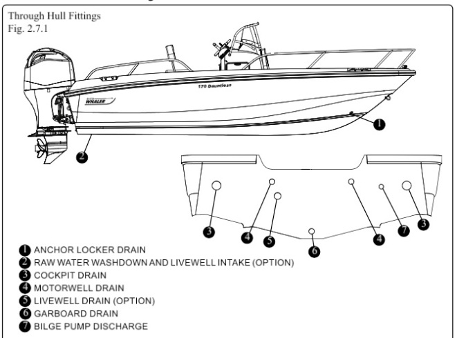

If you have the boat on a lift then PULL THE PLUG. It's #6 on the figure below.
Source: https://www.bostonwhaler.com/content/dam/boston-whaler/technical/owners-manuals/BW-170-DAUNTLESS-2021-OWNERS-MANUAL.pdf
If you rely on the pump and your battery fails, there may be a larger problem.
