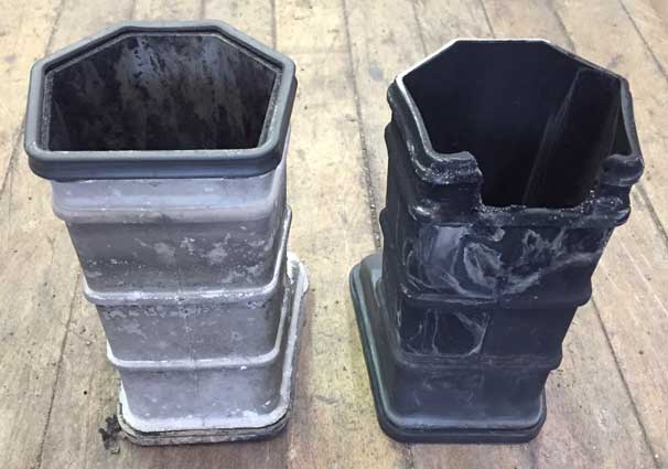

Exhaust Lower Inner Housing: during service in 2014 the exhaust lower inner housing showed erosion due to excess heat, and a new housing was installed. This problem was again found in the 2018 service. In 2018 a portion of the face of the upper seal was burned away, more severely than the previous instance of this same problem. The engine had already been provided with the extra cooling kit to mitigate this problem. As a new replacement part was not available on the shelf, a used housing in excellent condition was installed, thereby reducing the cost of the replacement part significantly from the now $142 price of a new housing.
Fig. 1. Two exhaust lower inner housings. On the right the housing from my E-TEC. On the left the housing from another engine without any sign of erosion and burning.

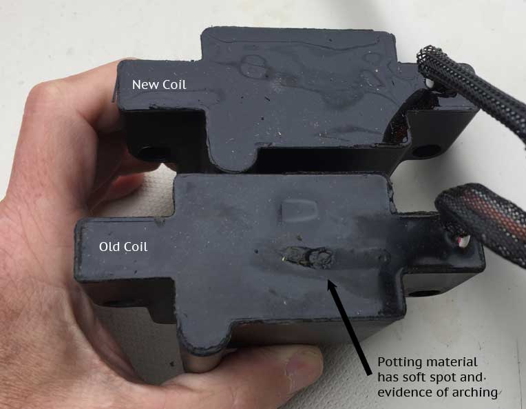

Engine Spark Coil: in late September 2018, a few days before this visit to the dealer, an Engine History report was taken; the report showed that five instances of CODE 103, "#3 Cylinder Ignition Coil Short Circuit Detected" had occurred in the last 20-hours of engine running time. During those 20-hours the engine had exhibited two instances of a misfire, the first two misfires ever noticed in ten seasons of use, These misfires occurred while operating the boat in remote northern Georgian Bay of Lake Huron, using fuel purchased at a local fuel dock in the region. At that time the cause of the misfires was suspected to be due to some fuel contamination. However, the engine history reported offered a different analysis and a new possible cause of the misfires: they could have been due to a failure of the spark coil for the #3 cylinder, as diagnosed by the EMM and reported in the engine history report.
With EV-Diagnostics software connected to the engine, the engine was started. Another CODE 103 was logged immediately after starting. The #3 cylinder spark coil wiring was carefully checked for possible loss of wire insulation due to abrasion and arching; no sign of wire abrasion or arching was found. The engine was stopped, and the #3 coil was removed and visually inspected. On the underside of the coil, an area not visible when installed on the engine, a soft spot in the coil housing was observed. This was interpreted as being caused by an internal short circuit or arching within the coil, with the heat generated causing a softening of the encapsulating insulation material. The #3 coil was replaced ($103), the engine restarted with the diagnostic software connected, and run for several minutes over a wide RPM range. No CODE 103 events were logged. The new coil was considered to be a remedy to the problem.
Fig. 2. Two ignition coils. The old coil has a soft spot in the potting compound which was interpreted as evidence of heating from internal arcing. The new coil surface is smooth and reflective; what appears in this image as a void in the potting is actually a reflection of wire harness onto the potting material surface.
The method of manufacturing the spark coils uses a plastic cast housing with an open bottom. The housing is inverted, the coil and wiring is placed in the housing, the the housing is filled completely with a potting compound liquid which is then allowed to dry. The path of the arc to ground was through the potting compound material.

  2. the exhaust lower inner housing has twice been replaced due to burning of its aluminum face, apparently due to higher than anticipated exhaust temperatures. The exact cause of this problem is not known, and this component will be checked again in the future for signs of further problems; there are two clues to this problem that can be noted without removal of the gear case: some soot appears on the midsection at the joint with the gear case where exhaust fumes exit; the engine makes a louder and throatier sound when running, due to the exhaust leaking directly to the atmosphere instead of being conducted out via the through-hub exhaust.
  3. the #3 cylinder spark coil began to show a short circuit. Amazingly, the engine EMM diagnosed and alerted me to this problem. The spark coil ($103) was replaced. For me, the ability of the EMM to detect problems like this and report them to the engine owner is really a terrific asset. Without the EMM telling me and the service technician about the problem with the #3 cylinder spark coil, the occasional misfires might have gone on for a much longer time, and been impossible to diagnose, a lot of mostly in-the-dark guesses about the cause, and perhaps a lot of trial-and-error replacement of suspected components. To get from the EMM a pointer directly to the cause of the problem was a big help.

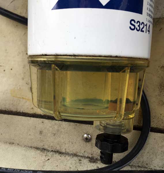

I just ordered a replacement element for the 10-Micron RACOR fuel filter (S3214). My filter has a clear bowl and there is no sign of water or debris. But I am going to change the filter element next Spring as a precaution. The filter was installed at least ten years ago. I drained off some fluid from the filter and it was just gasoline, no water present.
Here is a close-up of the RACOR filter and the lower clear bowl:
Fig. 3. RACOR 10-Micron fuel-water separating filter.

Yikes--maybe I should have ordered the part number with the filter AND the bowl. I will check for the "PUR" mark more closely as soon as it stops raining and the temperature gets above 50-degrees-F here.
Posts: 1804
Re: E-TEC Engine: Maintenance History After Ten Seasons
Postby Jefecinco » Sun Oct 07, 2018 10:49 am
I've been using Racor diesel and gasoline filters for 30 years without a single problem. The filters have saved me from engine problems on three or four occasions when I was sold water contaminated fuel. They are excellent products.

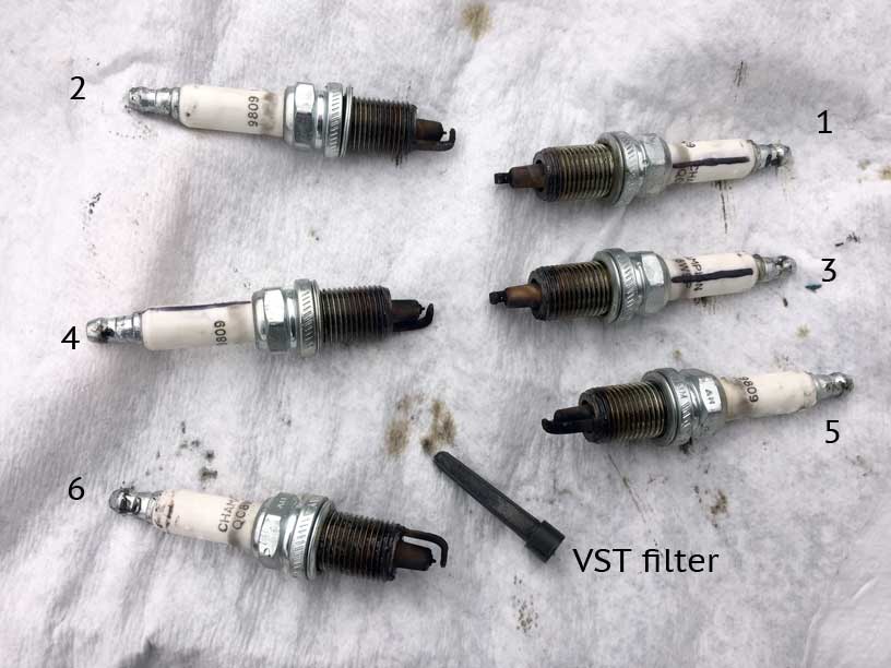

The image belows shows the Champion QC8WEP six spark plugs that were removed and the VST fuel return filter. These plugs had been in service for seven seasons and 265-hours of running time.
These images were taken on a very gray and cloudy day, so I added a bit of exposure compensation to reveal more detail in the dark areas.
Fig. 4. Spark plugs, identified with callouts by cylinder. The plugs appear rather dark in this image. My recollection is they were not quite this dark. The plugs seemed uniform in appearance.
Fig. 5. Close-up view of plug from #1 cylinder.
Fig. 6. Close-up view of plug from #3 cylinder.
The VST fuel line return filter, if held up to a strong light, looked like about one-third of the screen was filled with particulate at the narrowest part of the filter.

I assume the vertical marks on the spark plug insulators are indexing marks. On my 1999 OMC FICHT 115 HP engine I habitually replaced the four spark plugs annually when using XD100 oil. They looked much cleaner than your spark plugs but probably had only about 50 hours of use.
I would typically need to buy six spark plug for indexing but needed seven one year. I learned about indexing in the late 1950s as a pit crew member for a race team. It could be a challenge to get it done right between races.
Posts: 13394
Postby jimh » Mon Oct 08, 2018 11:33 am
Replacing spark plugs is one service that I could do myself without too much difficulty. But every 50-hours seems a bit too often for a modern low-emission engine with platinum tipped plugs. My non-towing car is a 2011 in service since November 2010, so for 8-years and 60,000 miles, and those plugs are original plugs. I have not pulled them out yet, but I plan to, more so just to get the steel plugs out of the aluminum head before they become frozen in place.
The E-TEC plugs are about $9, so a set of six would be about $54. If I bought seven plugs to get six that would index correctly, that's about $63. I guess that is not too much expense, but the suggested maintenance interval is three-years or 300-hours.
And, yes, the black lines on the insulator are marks for use in indexing the plug electrode opening position. The E-TEC service manual explains how the plugs should be oriented and how much torque can be applied to the threads to move the plug to that position. Because the manufacture of the plugs is not consistently done with regard to where the threads are cut and where the ground electrode is welded on to the thread base, not every plug will index in every cylinder. I don't know if the threads in the cylinder heads are all precisely oriented to be matched, either.

Re the exhaust lower inner housing:
I would want to know the root cause of that repeated failure. It sounds like a design fault and if that is the case the dealer should see lots of these failures.
Q1R: Is that why it was found "when the gear case was dropped from the mid-section"
Q2R:Did the dealer know enough about that engine's problems with housings to drop the lower leg to check it on its second service?
Q3R: If is is a design problem what does the dealer say is the specific problem?
Q4R: Is it overheat?
Q5R: Is it a problem with the material used in the manufacture of the engine?
Q6R: What is different about the 2019 Etec model or is it the same housing ?
Q7: Is there a manufacturer workaround for the problem of deformation of the exhaust lower inner housing such as a different thermostat (if [the cause of the problem] is overheat or is there a new material or improved replaceable part?
First time owner, long time admirer , 1970 (not 1963) 16 foot model being restored to a functional fishing platform
Posts: 13394
Postby jimh » Wed Nov 20, 2019 5:30 pm
RICK: here are my best answers to your seven questions as quoted above.
Rick W wrote:Re the exhaust lower inner housing: I would want to know the root cause of that repeated failure. It sounds like a design fault and if that is the case the dealer should see lots of these failures.
The gear case was removed to service the water pump. The exhaust housing burn was discovered when the gear case was examined because the exhaust lower inner housing came out with the gear case, as best I recall.
Rick W wrote:Q2R:Did the dealer know enough about that engine's problems with housings to drop the lower leg to check it on its second service?
The dealer did not drop the gear case with the specific purpose of inspecting the exhaust lower inner housing. The specific purpose was to service the water pump.
Rick W wrote:Q3R: If is is a design problem what does the dealer say is the specific problem?
The specific cause of the burn to the exhaust lower inner housing is not known precisely. The obvious cause is the rubber gasket became too hot, which allow exhaust gases to pass out of the housing. The flow of hot gases eventually caused the aluminum to soften and deform. There could also be a cause due to misalignment of the exhaust lower inner housing during assembly of the gear case to the midsection.
Rick W wrote:Q4R: Is [the burning of the exhaust inner lower housing caused by engine] overheat?
If you mean "overheat" as in the engine operating temperature being above the normal range, there was some operating time logged with engine operating temperatures above 190-degrees, but there was no time with the engine operating temperature above the upper limit that would have caused an alarm condition. With the original water pump, the engine did become prone to having high operating temperatures at idle speed ranges, but with the installation of a water pump service kit using the installation procedures for the pump impeller, the idle speed operating temperature range was reduced and now never gets above about 180-degrees.
Rick W wrote:Q5R: Is it a problem with the material used in the manufacture of the engine?
The engine is made from aluminum, which is the usual material from which outboard engines are made. The seal is rubber. If the housing were made from titanium it would tolerate higher heat. This part has been in use in Evinrude engines for decades.
Rick W wrote:Q6R: What is different about the 2019 E-TEC model or [does that engine use]the same housing?
In 2019 the legacy E-TEC V6 3.3-liter engine has been replaced with an entirely new engine, the E-TEC G2. There are hundreds of differences. The G2 is a substantial re-design of the E-TEC.
Rick W wrote:Q7R: Is there a manufacturer workaround for the problem of deformation of the exhaust lower inner housing such as a different thermostat (if [the cause of the problem] is overheat or is there a new material or improved replaceable part?
I am not aware of any specific recommended changes to the thermostat, although there are some optional thermostat that might produce a generally lower operating temperature. I am not aware of any change in material for the exhaust lower inner housing.
Although not asked, I will offer my opinion for a possible cause of the problem: the E-TEC engine mounting height on my boat is quite high due to mounting on the Whaler Drive and mounting at one-hole-up. The effect of those two factors produces an engine mounting with the lower part of the midsection--precisely the part that contains the exhaust lower inner housing--being above the water line. On normal boats with notched transoms, that part of the midsection is continually immersed in water. My inference is that when the lower part of the midsection is immersed in water, the exhaust lower inner housing is surrounded by water. That water provides cooling. Due to the high engine mounting, the lower part of the midsection is out of the water, and does not get the cooling benefit of being surrounded by cool lake water. This is illustrated at Figure 2a above.

I finally was able to get the water pump on the E-TEC 225-HP V6 engine serviced by a very competent and trusted dealer, Johnston Marine in Cheboygan, Michigan. Although 135-miles from me, he was closer than my usual best-dealer-in-the world, Lockeman's Hardware and Boat in Detroit, about 285-miles away.
In anticipation of finding that there would be a repeat of the problem with the exhaust lower inner housing having become distorted from excess heat, I had gotten a replacement housing ready. Dave Z at Lockeman's has a cache of these he has salvaged from old OMC V6 engines scrapped for parts.
The possible replacement housing was from an older OMC engine--the same part and design has been used for many years in OMC and now BRP engines. This possible replacement part was covered in soot and exhaust residue, I spent about two hour (or more) cleaning off what was probably several decades of soot from the aluminum casting. I sprayed it with some ancient can of carburetor cleaner fluid, which dissolved much of the grime. Then I vigorusly scrubbed it for another hour with detergent to remove what remained. When done I had a much cleaner replacement part.
I suspect if I had not had a like-new replacement housing on hand, one would have been needed. That is just how problems often work out. Preparation stops the problem from occurring--or so you'd like to think.
With all this preparation, when the lower leg was dropped and the exhaust lower inner housing could be inspected, there was no sign of any distortion, melting, or leaking of exhaust due to bad rubber seals. So the replacement housing was not used; the existing one was left in place.
This service happened about three weeks ago, but I have not had a chance to get the boat in the water and run at idle speeds for extended periods due to the usual interference with boat work by other problems from life in general. In a future update I will report on the outcome of the water pump service. Also, the "whole" water pump service kit was used, not just an impeller replacement. More to come.
