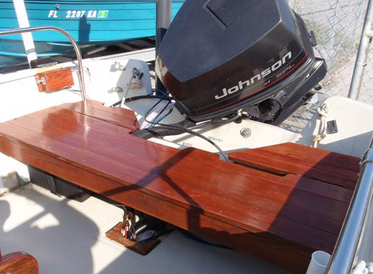

I have a newly acquired 1988 Whaler Montauk 17. Is the wood on the console factory original? Or, a later added custom item? I am relatively sure the back seat is custom. Has anyone seen a console with [wood added]? Thanks--Tom

Postby Phil T » Fri Jul 29, 2016 12:44 pm
The fiberglass console is original. The wooden gauge panel and top shelf have been added--a nice touch.

kwik_wurk
Posts: 110
Re: MONTAUK 17 Console with Wood Trim
Postby kwik_wurk » Mon Aug 01, 2016 4:25 pm
The wood is likely due to some modifications (newer engine for example or fish finder). Often these changes over time leave the console looking like swiss cheese. -- Hence the aluminum gauge plates (where the helm is) and the top wood top plate have been replaced with teak or mahogany.
The rear bench seat is nice, and will add functionality to the boat in a general sense. The rigging tunnel cover is also changed as it is typically a rectangle, and not the U-shape as shown. Plus the wood enclosure for what looks like the [electrical connections for the navigation lamps].
All of these look well done.
