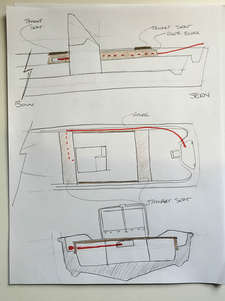

Actually, it is an easy conversion. You do not have to cut a rigging tunnel to install a center console. Nor do you have to make it look anything but OEM...
If you want to convert a sport or any 15 to a center console, it requires building two new OEM style tall seat risers (one with a rigging pass-thru) and two new twart seats.
Then, you need to make the rigging exit out of the front of the center console, run the rigging under the front thwart seat and to the side gunwale, then turn the rigging and run it between the riser block and the hull back to the motor just like a sport or super sport does.
See the attached drawing

You could use a cooler instead of a rear thwart seat if you wanted.

BINKSTER (Rich) did very nice work on his modified 15-footer. Workmanship like that is what is needed if you start making modifications. All modified boats are not intrinsically done to perfection.
JEFF--I like your idea for the center console without boring the rigging tunnel.

Using the front thwart to route the cables is a neat trick! However, if the original poster is looking at an optimized fishing setup, he may not want a thwart at all.
