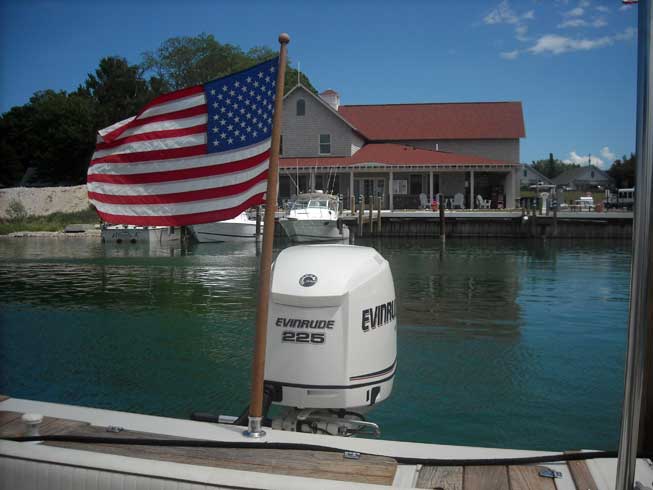

jimh |
posted 06-13-2010 01:44 PM ET (US)
In case you were wondering how we got to Leland when the day before the lake had 20 to 25-knot southwesterly winds and four-foot seas, it was a matter of good timing. We left Northport about 10:30 a.m., rounded the Grand Traverse Light before noon, and found Lake Michigan with two to three-foot waves from the west. In those conditions we drove on plane at about 18 to 20-MPH, until we ran into a set of three big waves that changed our minds about running at that speed. Shortly after that we ducked into Cat Head Bay for a lunch break, were we could relax in the lee of a little point and eat a sandwich. When we went back to the lake, the wind was almost gone, and the seas were laying down. By the time we made the breakwater entrance at Leland around 1:45 p.m., the wind was nearly calm. No sooner had we made CONTINUOUSWAVE fast to the new floating docks about 2 p.m., the wind switched to southwest and piped up to 20 to 25-knots, holding flags out straight and snapping. It blew like that all afternoon, and by 4 p.m. there were white caps as far as you could see. You can see the flag in the picture below, and it was in the marina, behind the sea wall. The big flag on the marina 50-foot tall flag pole was really out straight. This experience reaffirmed my belief that late afternoon in the summer on the Great Lakes is generally the worst wind and wave conditions. It is much better to leave early and miss that 4 p.m. wind peak. You can also see the new Leland marina office and bath house, which just opened. Its facilities are nicer than most yacht clubs I have visited. We enjoyed watching the Stanley Cup Finals GAME 6 in high-definition television from the boater's lounge on Wednesday evening. |
