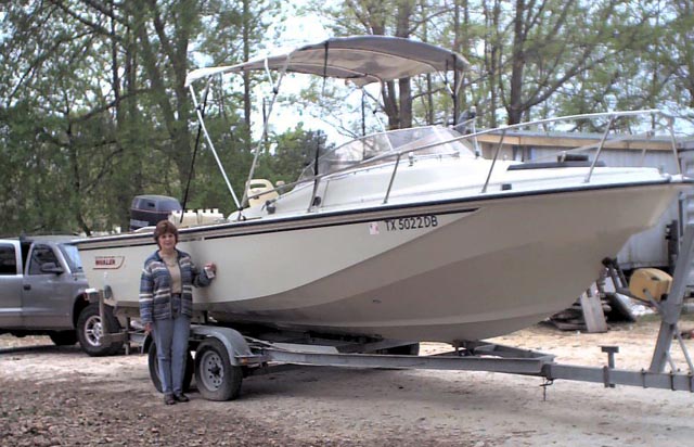

By the way, do you really have a REVENGE CUDDY 22 model? I would like to see a picture, as I don't think I have ever seen one before. Most 22-footers are the plain REVENGE or the REVENGE WT (Walk-through) model.
Tom W Clark posted 03-01-2014 03:19 PM ET (US)     Profile for Tom W Clark  Send Email to Tom W Clark
http://continuouswave.com/whaler/cetacea/images/22RevengeCuddy640x412. jpeg

I think Tom is trying to suggest that in October of 2002 I must have seen that image, as that is the date of that file upload. I guess Tom has better recollection ab antiquo than I do.
To get to the actual question I asked of Mobjack: is your boat a REVENGE CUDDY 22? The reason I ask: I suspect the REVENGE CUDDY may be lighter than a REVENGE or REVENGE WT. That may enhance your fuel economy.

That photo is, ironically, the first photo that popped up.
The Revenge 22, Revenge 22 Walk Through and Revenge 22 Cuddy all have a specified weight of 2350 pounds.

By the way, the boat under discussion is a REVENGE CUDDY 22. You'll have to take my word on that. In my collection of specifications at
http://continuouswave.com/whaler/reference/specifications.html
that model is listed with the notation "Info needed." (And, Tom, "Info" is an abbreviation for information, just to be clear. It is another situation of limited space in a table cell that caused the abbreviation to be used.) If anyone has the official hull weight and other specifications, I would be pleased if you sent them to me via email. I will update the information in the listing. It is always great to get collaborators helping collect information.
