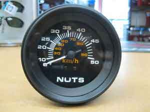

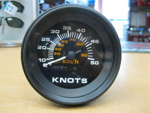

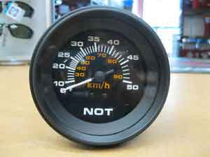

Both OMC and Mercury/Quicksilver made speedometers calibrated in knots. Nothing particularly unusual about them. http://i.ebayimg.com/00/s/NDgwWDY0MA==/z/xioAAOxygj5Snfwi/$_35.JPG My iPhone, Garmin handheld GPS and FURUNO GPS Chart Plotter all offer knots as a unit as speed measurement. Not sure what any of this has to do with the veracity of Brian's performance report but Jim's rant about the use of knots as a unit of speed seems rather bizarre. |
