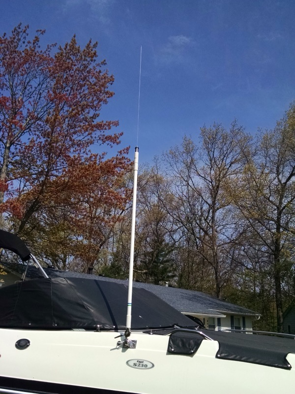

A 3-foot metal whip with base coil mounted on a tall extension mast makes a great antenna for a small boat. Photo credit Don McIntyre
IMG_2876 640x480.jpg (206.72 KiB) Viewed 36931 times

I looked at the fitting of the GAM SS-2 antenna into the GAM ADAP-2 mount again. The internal diameter of the ADAP-II is 1.000 inches and the outside diameter of the SS-2 is 1.003 inches. I was just not twisting the antenna hard enough when trying to thread it fully into the mount. After going back and forth a few times, the SS-2 is seated down in the ADAP. This is all probably intentional to give a good fit, and I was just trying to be too careful.

Ok, all done. I finished last night about 11:00 p.m., and, not surprisingly, nothing came across the radio. I went to bed wondering if I did something wrong despite knowing that there would be little radio traffic at that time, especially this time of year. This morning I turned the radio on and started cleaning the boat and heard the Elk Rapids harbor master hail a boat. I was in my front yard about 15 miles away, so that's one good indication.
Posts: 13285
Re: VHF Marine Band Antenna for Small Boats
Postby jimh » Sat May 21, 2016 7:47 pm
You installation looks good. Thanks for sharing the nice images of your work.
