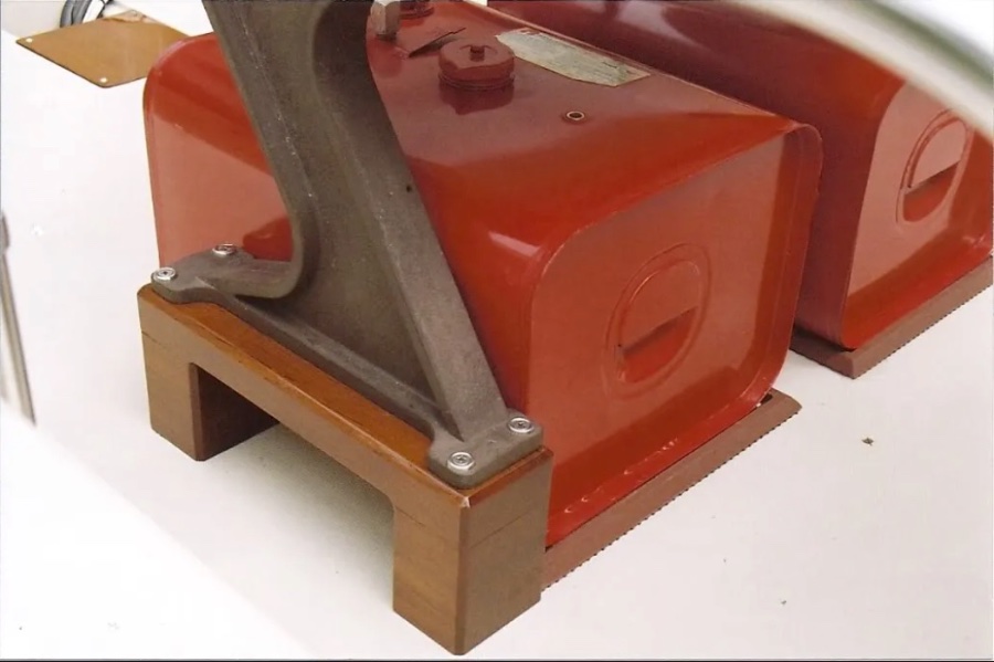

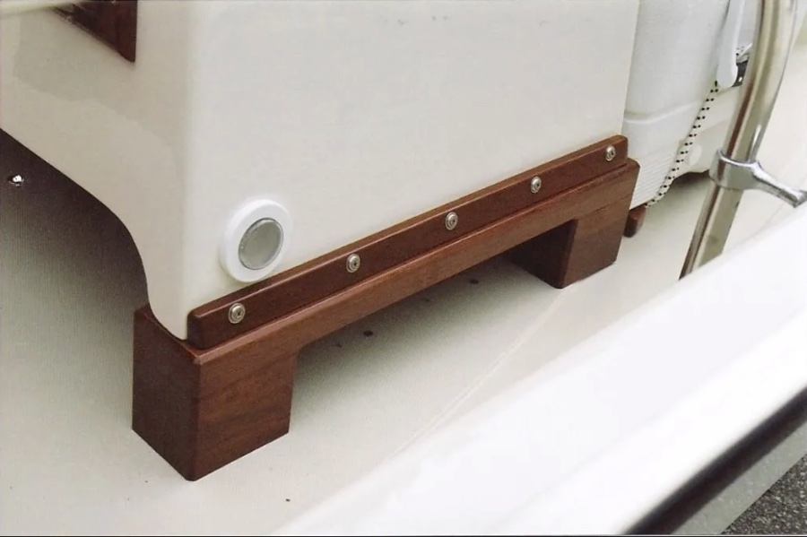

The alternative style that is very popular is wood blocks and a top plank. This design is also used for the console.
Below are two photos showing this style that was created by LHG. I have copied the photos from his photobucket album since that site is full of bloatware, popups etc.
If you are dead set on using starboard, I would contact Ray Martin of Martin Marine Design. He CNC's starboard for custom client platforms and could whip up a set. http://www.martinmarinedesign.com
Fig. 1. Console riser made with four planks.. Photo Credit: LHG
Fig. 2. Seat riser made with four planks. Photo Credit: LHG

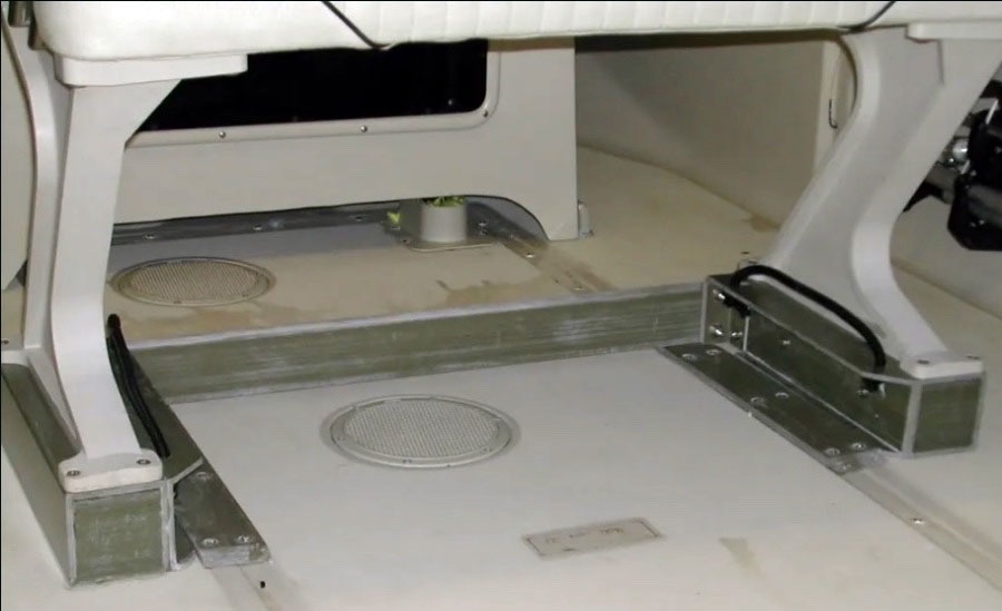

I have seen somewhere, an owner fabricated risers out of aluminum. He welded up a custom I beam. He bolted the leg into the top of the I and into the floor using screws from the bottom of the I.
I recall he did it to allow stowing a 56 qt cooler with cushion under the RPS.

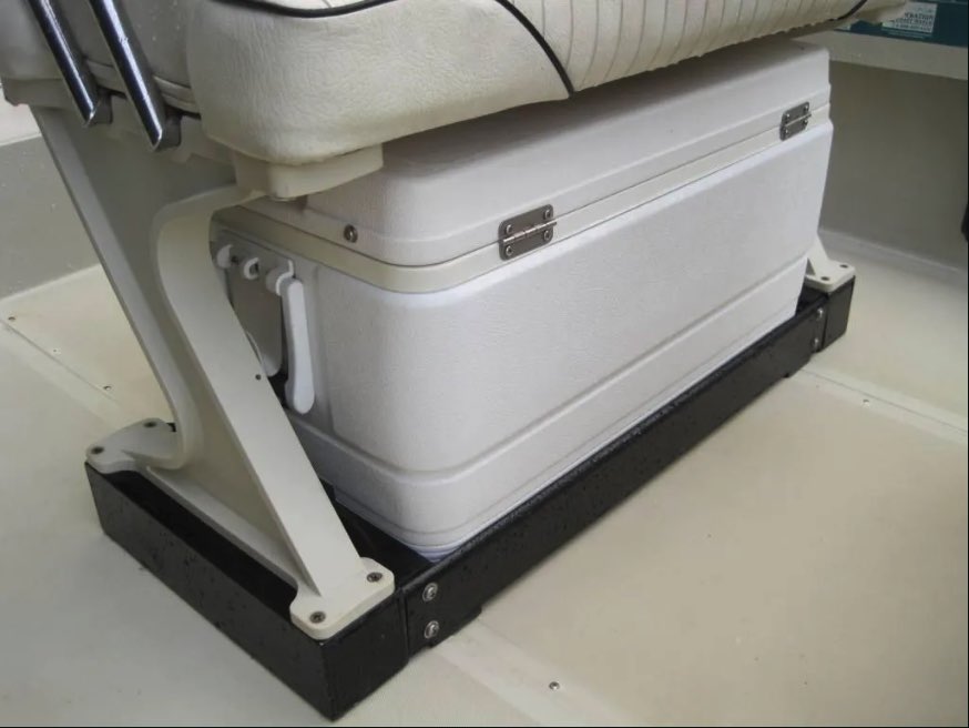

From a fellow Outrage 17 owner:
The previous owner of my Outrage 17 made [risers from] black fibre-reinforced plastic (FRP) channels and angles bought from McMaster-Carr and jointed with stainless steel [machine screws]. [The risers] turned out nicely, By raising the RPS by three-nches a 72 quart Igloo cooler can fit under it.
Fig. 3. RPS riser, front view
Screen Shot 2020-11-28 at 12.54.11 PM.jpg (57.43 KiB) Viewed 8537 times
Fig. 4. RPS rise, stern view

Phil- Thank you. I like the design there as it looks like it would secure the cooler much better than the traditional bungee/handle method. IS this still your Outrage? If so, I might ask for some additional pics of the joinery--which is really nice, and three-feet looks perfect.
Re: Reversible Pilot Seat Four-Inch Riser Made of Black KING Starboard
Postby Phil T » Sat Nov 28, 2020 4:06 pm
As I said, not my Outrage 17.
I do know the owner and will reach out and see what he has.

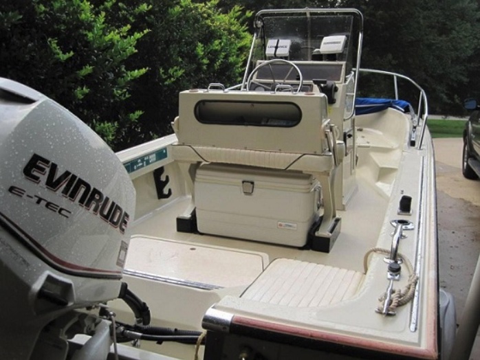

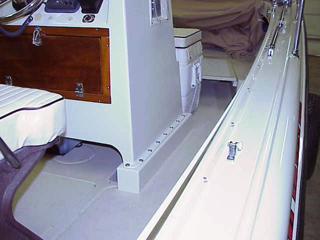

I used a combination of riser material for the console and seat; Starboard for the seat (three one inch sections) and four, one inch sections of oak for the console. The console riser sections were epoxy laminated, then painted to match the console. I had seen Larry's beautiful job, and I didn't want to be on my hands and knees every year during off season, re-varnishing and covering the inevitable bumps and scratches gained over the season.
Fig. 5.
Fig. 6.
The Starboard risers are secured to the deck with long machine screws. The console risers are secured using counter sunk wood screws and 5200. The console is attached to the risers also with wood screws, more than the company used.
Regarding the height of the seat. It's personal pref, but you don't want your feet dangling.

My friend actually bought the boat with the risers from CW member KDW. The boat has been sold two times since this was originally posted in 2011.
Here is the thread:http://continuouswave.com/ubb/Forum3/HTML/012992.html
Kenny Wyndham (KDW) [made the risers] out of FRP (I think it's Fiber Reinforced Plastic) C-channels and square tubing brought from McMaster-Carr and secured together with SS hardware
Fig. 7. View with cooler removed to show more details of the construction of the riser and crossmember.

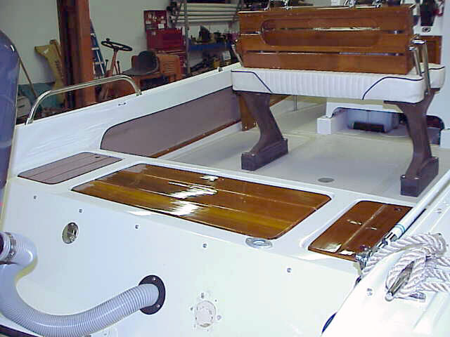

The risers shown above are all very functional and have a nice appearance. But my all-time first choice for how to make a riser are these two examples from Jerry--a real carpenter. His tapered bases are really the most stylish.
Fig. 7. Tapered wood varnished console and seat risers from SPOUTER, Jerry's very fine OUTRAGE 22 boat.
ASIDE: Jerry passed away several years ago. I think his boat SPOUTER ended up being owned by his nephew.
The risers made by Larry all had straight cuts. I don't think Larry owned any carpentry tools, and he had all the lumber cut at the lumber yard. His designs were crafty because they were all square cuts. Anything made from wood on Larry's boats gets eight coats of varnish--and retouched frequently to hide scratches.
Don--your aversion to piano high-gloss finish on the risers is probably a good choice. They are going to absorb some bumps and kicks.
