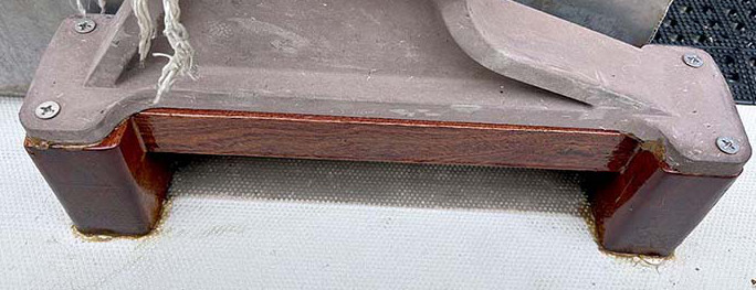

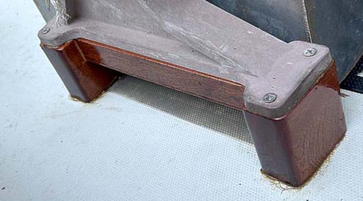

Postby ddqarch » Wed Jul 01, 2026 10:31 am
[My construction of wooden risers to increase the height of a Reversible Pilot Seat on my MONTAUK 17] came out well.
Fig. 1. A wooden riser used under the Z-legs of a Reverisble Pilot Seat to increase the seat height.
Fig. 2 Another view of the riser.
I used Sapele wood I had on hand. I soaked the wood with penetration epoxy. [When the epoxy was cured I then applied] two coats of varnish. I need to clean up the Dolphinite [visible in Figures 1 and 2] that squeezed out at the deck.
The total increase in height of 3-1/4-inch has made the seat height much more comfortable.

Q1: as seen in Figures 1 and 2, how is the new wooden riser fastened to the deck of the MONTAUK 17?
Q2: what is Dolphinite?

jimh wrote:Q1: as seen in Figures 1 and 2, how is the new wooden riser fastened to the deck of the MONTAUK 17?
I replaced the original #14 x 3-inch stainless steel screws with #14 x 6-inch stainless steel screws. They go from the top of the seat brackets, down through the new wood risers, and into the hull using the original screw holes.

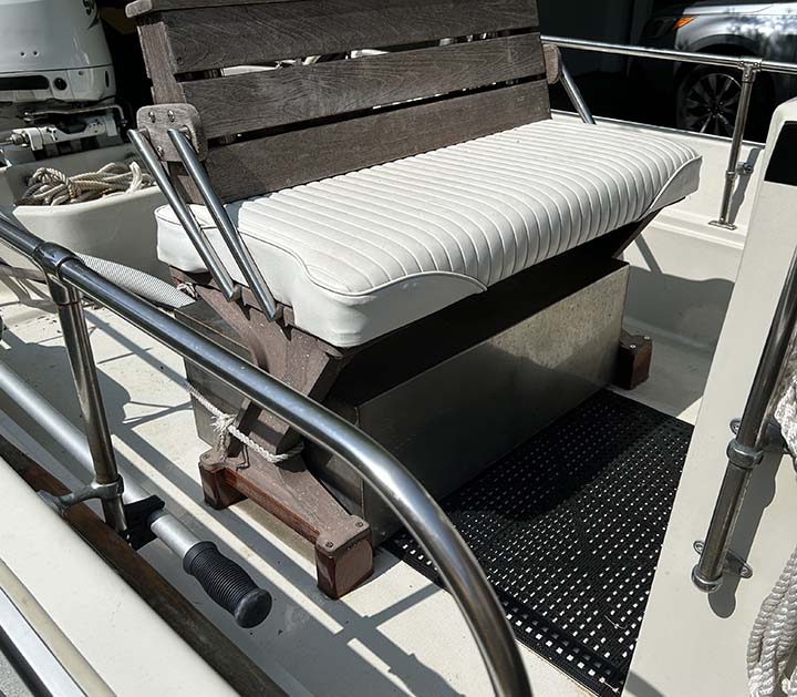

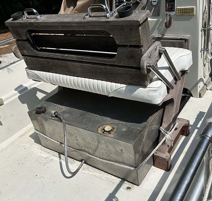

Thanks for the kind words about the risers. I am including a picture including the whole seat as per request.
Fig. 3. Reversible Pilot Seat
Fig. 4. Reversible Pilot Seat with very unusual method of retaining metal fuel tank in place.

Postby jimh » Fri Jul 03, 2026 9:55 am
Based on Figure 4, you need to apply your woodworking skills to produce a better method of securing that metal fuel tank in place.
ddqarch
Posts: 19
Joined: Thu Oct 14, 2021 7:49 pm
Re: Leaning post on a Montauk 17
Postby ddqarch » Fri Jul 03, 2026 10:16 am
jimh wrote:Based on Figure 4, you need to apply your woodworking skills to produce a better method of securing that metal fuel tank in place.
Agreed! The tank fastening was like that when I bought the boat, and it works, and I am lazy, and so I haven't gotten around to making it right yet. But your comment may prompt me to get on it.
Posts: 13336
Re: Holding Down Fuel Tank Under an RPS
Postby jimh » Fri Jul 03, 2026 4:17 pm
A proven method for holding down and in place an on-deck fuel tank is to use straps that pass through Footman's Loops.
For example:
https://replacementboatparts.com/products/2-stainless-steel-footmans-loop
For a more woodworking approach, make some wooden low-profile retaining corners or "cleats" (and that is "cleat" not in the sense of a horn cleat used for making fast a line. but in the wood construction sense of a strip or block of wood fastened to a surface as a mounting point or retainer, such as "cooler cleats"). Generally the weight of the tank and the fuel inside the tank will tend to keep it held down to the deck, you just mostly have to constrain its tendency to slide on the deck surface. Using a rubber mat under the tank will also help to keep it in place. However, wet rubber and aluminum or steel don't go well together/

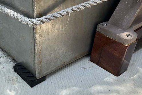

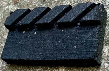

Postby ddqarch » Sun Jul 05, 2026 2:55 pm
Figures 5 and 6 below show my attempt to improve fuel tank mounting.
Fig. 5. A rubber cleat.
Fig. 6. Tank held in place by rubber cleat.
I made cleats out of leftover rubber strips I had on hand. I cut them to roughly 2-inches x 3-inches, and made a lip to keep the tank from sliding aft.
I adhered the cleats to the deck with 3M4200, because I did not want any additional penetrations in the deckl. I don't have much experience with 3M4200, and I do not know how strong the bond between rubber and fiberglass will be. The front three-quarters of the tank is sitting on DryDek mats that extends to the center console, so the aft side cleats help to keep the tank at an even deck level.
ASIDE: the rope remains in place until the 3M4200 fully cures.

I was hoping for feedback on the cleats.
You had mentioned earlier that rubber and metal in contact can sometimes cause problems.
Q3; what is the adhesive strength of 3M 4200 for this application?
Thanks for all the previous feedback.
Posts: 13336
Re: MONTAUK 17: RPS or Leaning Post
Postby jimh » Tue Jul 07, 2026 9:26 am
ddqarch wrote:I was hoping for feedback on the cleats.
I think you will be the first to know how your rubber cleats will work out in the long run. I don't have any basis from my own experience to offer advice. It does seem like a novel solution.
ddqarch wrote:You had mentioned earlier that rubber and metal in contact can sometimes cause problems.
The continuing presence of water held in a rubber spacer that touches the aluminum metal of a fuel tank when the fuel tank is in a closed-off cavity has been suspected to cause pits and erosion in the aluminum. The rubber cleats you have are going to be continually exposed to air so they should dry out rapidly if they get wet.
ddqarch wrote:Q3; what is the adhesive strength of 3M4200 for this application?
I think you will be the first to know. I don't have any basis from my own experience to offer an opinion. About all I can say about 3M4200 is that it is supposedly less permanent than 3M5200.
