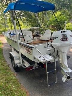

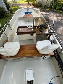

Q1: what was the model designation for the c.1971 17-footer seen below in Figure 1 and 2?
Q2: is the boat seen in Figure 1 and 2 in its original configuration?
Fig. 1. A 17-foot hull with an unusual console, and a bench thwart seat to which two plastic bucket seats have been attached.
whaler bucket seats.jpg (14.83 KiB) Viewed 3256 times
Fig. 2. Another view of 17-footer with bucket seats and side console.
Q3: would a MONTAUK 17 have two bucket seats?
Q4: would a MONTAUK 17 have a side console?

Little Mule wrote:Q1: what was the model designation for the 17-footer seen below in Figure 1 and 2?
The boat was probably a SPORT 17. It certainly was not a MONTAUK 17. The side console with windshield is unusual, but may have been an original element. The extension of the side console to Port is unusual.
Little Mule wrote:Q2: is the boat seen in Figure 1 and 2 in its original configuration?
The boat is likely not entirely original. The mounting of bucket seats to the thwart bench seat was most likely not original. Also the side console with small windshield may be an original Boston Whaler part, but the extension to Port does not seem an original element.
If you are on Cape Cod, the dealer selling this boat may have been NAUSET Marine. They may know more about the history of this boat. They are an original Boston Whaler dealer from the company's earliest days. If NAUSET Marine was the original selling dealer of this boat, it is possible they were ordering boats from Boston Whaler in a non-standard configuration, or ordering a boat as a SPORT 17 and then modifying it.
It is also possible a previous owner bought a SPORT 17 and modified it himself.
Little Mule wrote:Q3: would a MONTAUK 17 have two bucket seats?
A MONTAUK 17 could have two bucket seats, but they would NEVER be mounted to a wooden thwart seat. They would be mounted on pedestal bases fastened behind a CENTER CONSOLE. This was a common element of a MONTAUK 17 if the optional Reversible Pilot Seat was not selected.
Little Mule wrote:Q4: would a MONTAUK 17 have a side console?
No. The essential element of a MONTAUK was a center console and no wooden thwart seats. On those two criteria alone, the boat seen in Figures 1 and 2 is not a "Montauk."
There is a common misuse of the model designator "Montauk" by people not particularly familiar with Boston Whaler boats to attach that term to any 17-foot classic era hull no matter what the interior configuration might be.

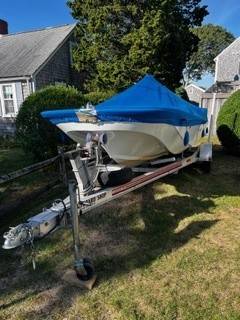

Neither Figure 1 or Figure 2 show the bow of the boat. The bow configuration is an important element of the 16/17 foot hull. Hulls produced prior to 1976 were designated as "16" models. In c.1976 the original 16-foot hull was redesigned so the bow shape incorporated what has come to be known as "the smirk."
Read the long article on the 16-17 foot hull to discover all the details of the smirk bow design and other changes for the models designated as "17" hulls.
A c.1981 "17" would certainly have the smirk bow.
Also, the 110-HP engine seen in Figure 2 will likely exceed the maximum horsepower rating on the boats USCG required safety information placard which declares a 100-HP limit.
Fig. 3. View of Bow of 17-footer showing Smirk hull, trees, neighbors house, trailer.
