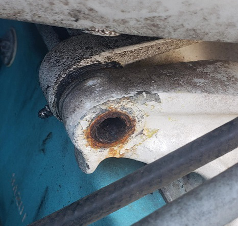

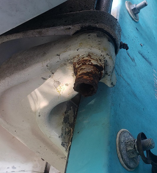

Please identify the component shown in the illustrations below that is part of c.1985 Johnson 90-HP outboard engine on my 17-footer.
Fig. 1.
Fig. 2.
I believe this may be called the pivot tube, the tilt tube, or the steering tube.
The interesting part is the tube on the left side appears to be sheared flush, but the nut doesn't have any tube inside and looks like it just unscrewed.
Q1: what is the degree of difficulty to replace this unidentified part?

Kolbert wrote:Please identify the component shown in the illustrations below that is part of c.1985 Johnson 90-HP outboard engine on my 17-footer.
The part shown in Figures 1 and 2 is called the tilt tube.
The end shown in Figure 2 appears to have been sheared off. That is probably where the loose large nut in the cockpit came from.
Typically the tilt tube can be driven out of its position in the engine mounting bracket. With the amount of rust seen, proceed carefully. Usually application of heat and penetrating oils will help loosen the tilt tube.
Because removal of the tilt tube will cause the engine to fall off the mounting bracket, the usual approach is to have a new tilt tube ready to be immediately driven into place as the old one comes out one side at a time. You should support and stabilize the engine when attempting to remove the tilt tube.

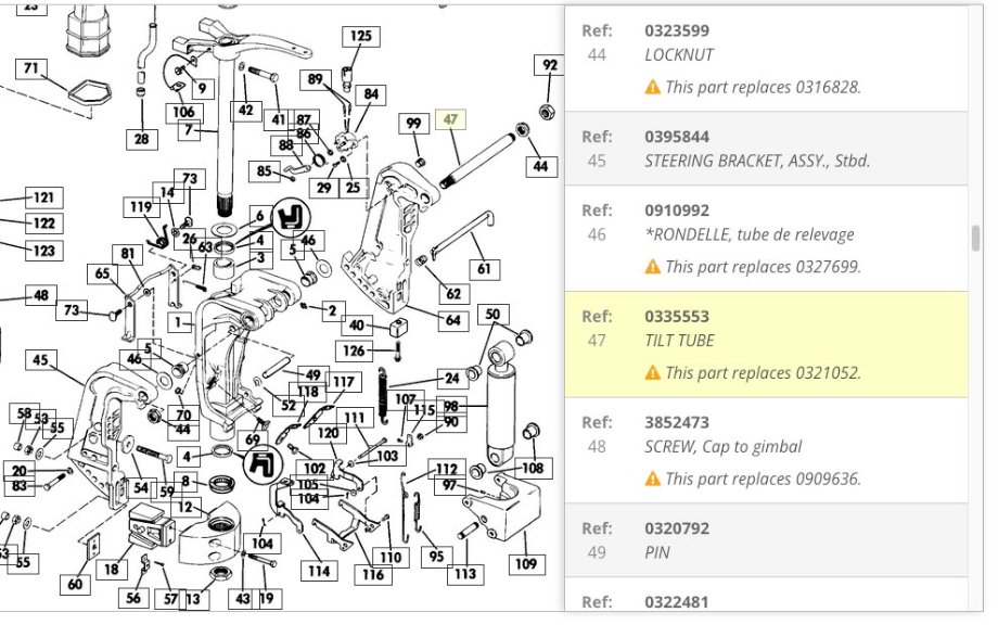

You can find the OEM parts diagrams online at
https://epc.brp.com/
I located your engine using the specifiers JOHNSON / 1985 / 90 / J90TLCOS / MIDSECTION
The replacement part is number 0335553
Fig. 3. Partial view of detailed parts diagram available from epc.brp.com showing the TILT TUBE as CALLOUT 47.
