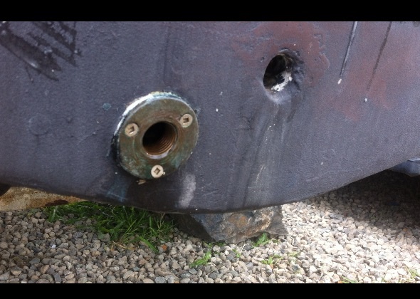

I've attached an image that hopefully better illustrates my concerns. Water drained from the metal plug for quite a while, certainly more than a couple of gallons. Is that draining the area between hull and deck? And does this mean my hull been modified?
- image.jpg (94.88 KiB) Viewed 11919 times

Show a wider view of the boat transom as seen from astern.
Re: 1985 MONTAUK 17 Drains and Waterline
Ok I will do, when I am home tonight. If it helps for perspective then that thru hole (without brass plug) is the dead center hole that goes through to the sump. The brass plug is to the port side of the hull

On the basis of you further description, I do not think that brass fitting to Port of keel center on the transom well below the waterline is an OEM fitting. Compare with the hull shown here:

What does that unusual brass fitting lead to? To what sort of sump or hose does it connect?
Good question. I was hoping someone would be able to tell me. It is hard to see in there, I shined a light up and it looks similar to the thru hull cavity from the sump, but I can see maybe 4-5 inches in at most. There is certainly no other 'end' to it unless it is really well hidden
From looking at diagrams of the whaler construction I don't see where it can lead other than into the hull itself.

Wow. That is a strange item. It looks like a decent grade marine thru-hull, but attached with Home Depot deck screws. Maybe there was [and still is] water in the hull, and that is how someone rigged a drain. The OEM drain looks pretty beat up, too. And an attempt was made to seal it up with something.
Why not get the proper plug, insert it, and test on the water again?
If water still gets in then the OEM drain can be repaired, But I would seal that other opening for good with fiberglass or Marine Tex.

If the non-OEM, added hole in the transom leads to nowhere, it makes no sense, except as some prior owner's misguided notion of how to let water soak into the interior foam, or, perhaps, how to let water out of the interior foam.
With the boat out of the water, presumably on its trailer, orient the boat so the bow is elevated with respect to the transom. Let any water in the hull drain out of both holes in the transom until they dry out.
Find a plug for that added hole. It probably has some sort the thread-in plug.
Inspect the OEM drain, the one on keel center. Make sure the drain has a brass tube liner. See the FAQ on repair of hull drains at:
Q12: How Are Drain Tubes Replaced?
http://continuouswave.com/whaler/reference/FAQ/#Q12
Once these two below-water-line drains are repaired or plugged, carefully inspect the hull for any sign of a poor repair to hull damage. Properly repair any hull damage you find.
Put the boat back in the water. Let it soak for a few hours. Haul it out, remove the plug from the non-OEM drain, and check for any water in the hull interior. If you find water, something is letting water into the hull. Look for the path.
If you find no water, then consider repairing that hole, removing the brass drain outlet, and repairing the laminate and gel coat to completely seal it up for good.
Contact a previous owner to ask what he was thinking when he installed the drain.

Can you send a picture of the entire transom, and with a stick (or similar) to measure how far that hole goes. I am sure you could fish a coat hanger or something to figure it out.
And the [center line] drain looks a little "patched", to say the least.
