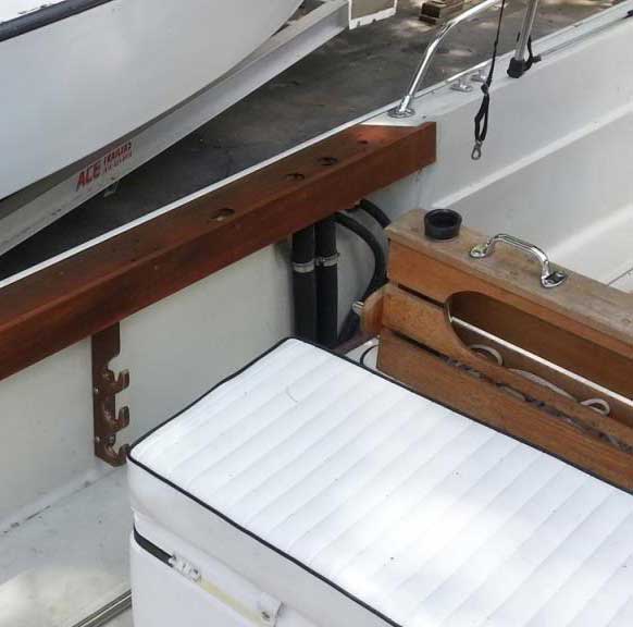

I came across some images that perhaps show the problem area. I thought this would be an interesting topic for discussion because, as far as I can recall, the area that cracks and what is causing this has not been illustrated before.

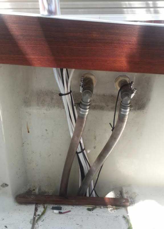

The weakening of the hull structure seems to be a thinning of the hull sides in the area where the fuel lines are carried upward. This can be seen in these views (which were recently posted and linked-to in another thread, but here I have reduced the images a bit to make them fit in-line):
See original at http://i1205.photobucket.com/albums/bb434/russellbailey3/Radar%20Arch/2013-05-31145706_zps6ec577f7.jpg
See original at http://i1205.photobucket.com/albums/bb434/russellbailey3/Radar%20Arch/2013-05-30133149_zps65378c60.jpg
I certainly do not mean to suggest there is any problem with the boat shown, I just wanted to use the images to illustrate the hull configuration at the point where the problem has been suggested to occur and to verify if this spot is, indeed, the site and the cause of the problem. Any informed comments or opinions are welcome.

jimh, photo Outrage25HullSideStarboard.jpg is of the bilge pump through hulls, and is not quite as thin as the fuel vents. For the fuel vents on the port side, Whaler cut away the inner fiberglass and the foam and has them simply attached to the thin outer fiberglass.
I've wondered about the cracks, but have no signs of them on my boat so far, and it is a 1984 (and the one shown in the photos) and hope that continues. I have tiny gelcoat cracks around the fuel vent from flexing in that thin outer fiberglass-only area, but that is it.
I'll be curious to see about the experience of others.

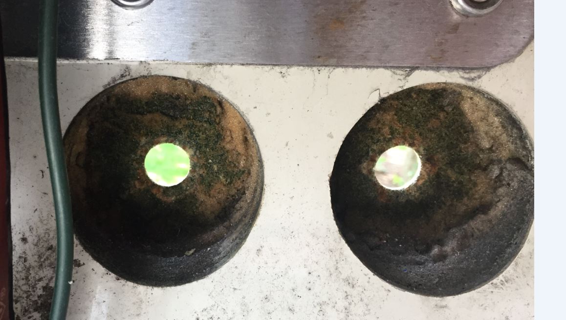

Postby russellbailey » Tue May 30, 2017 10:07 am
Attached is a close up of the fuel fill holes on my boat. The fuel tank vents attach only to the single outer layer of fiberglass, and the foam is exposed internally. It is clearly a weak spot.
The forward hole had some radiating stress cracks in the gelcoat around it from the flexing of the fiberglass skin - the fiberglass showed no cracks but the gelcoat did. They have been there for some time.
I reinforced the area with two pieces of thin luan plywood as backing. I cleaned up the inside of the hole and used West 6-10 epoxy to both coat and bond the two pieces of wood from the inside over the entire interior part of the fiberglass. After that set, I then added fiberglass cloth around the exposed foam area. Once it all hardened, I re-drilled the holes from the outside and re-mounted the vents. It is now quite solid.
It was a poor design for sure, as the the small diameter fuel vents can put a good twisting motion on the thin fiberglass. But, it has lasted 33 years without being touched, so that is not bad.
