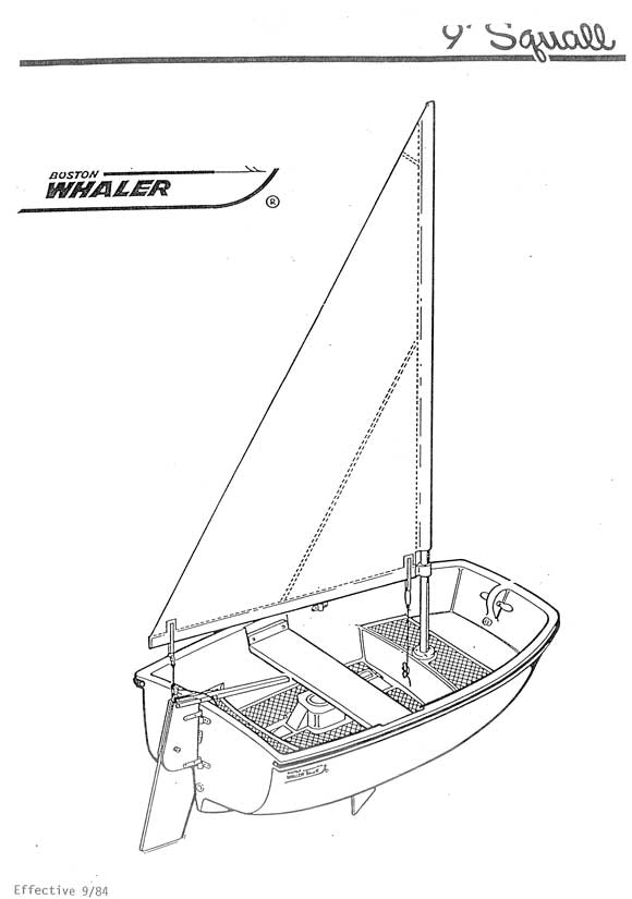

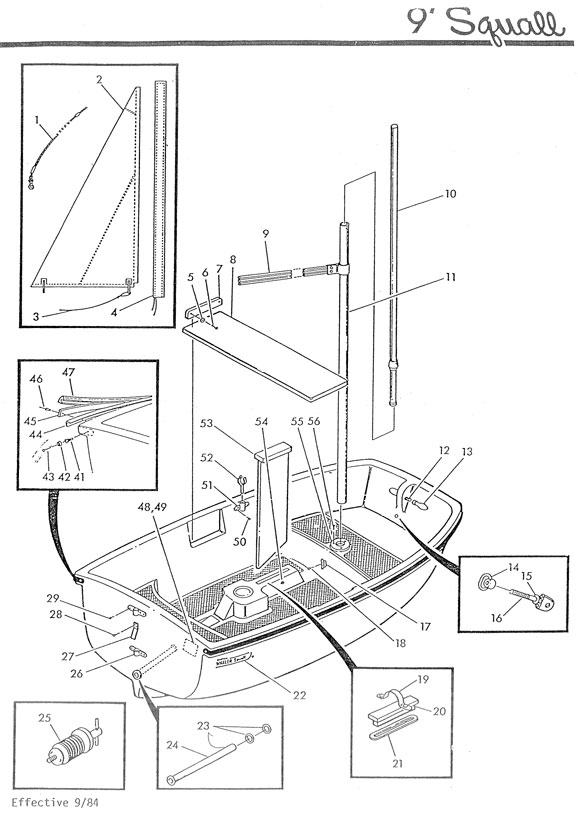

Below are several drawings of the SQUALL 9. The other 43 drawings are mostly mechanical drawings giving details of the fabrication of particular components made by Boston Whaler.
Fig. 1. SQUALL 9 from a Boston Whaler drawing.
Fig. 2. SQUALL 9 assembly drawing with callouts.
LEGEND
1 Mainsheet
2 Sail
3 Downhaul, 5-feet
4 Boot, rig
5 Washer, Finish #10
6 Screw, #10 x 2
7 Cleat
8 Seat
9 Gooseneck/Batten
10 Mast, upper
11 Mast, lower
12 Stud, 3/8 x 3-7/32
13 Pin, Norman
14 Nut, Eye, Lifting
15, Seal, Eye, Bow
16 Eye, Bow
17 Cleat, Downhaul
18 Screw, Bronze, #8 x 1-1/2
19 Strap, Retaining
20 Cap, Plug, Daggerboard
21 Gasket, Plug, Daggerboard
22 Decal
23 O-ring
24 Tube, Drain 14-inch
25 Plug, Drain
26 Gudgeon
27 Lock, Ruddre
28 Screw, #8 x 5/8
29 Screw #8 x 1

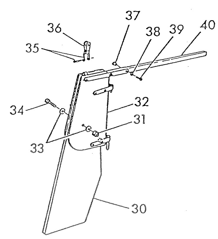

Fig. 3 SQUALL 9 Rudder detail.
30 Rudder
31 Stopnut
32 Head, Rudder
33 Washer, Flat #1/4-inch
34 Screw #1/4-20 x 1-1/2
35 Shackle, Sailmakers
36 Block, Mainsheet
37 Nut, Barrel, #10-24
38 Washer, Finish, #10
39 Screw, #10-24 x 1
40 Tiller

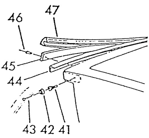

Fig. 4. SQUALL 9 Rubrail detail
LEGEND
41 Anchor, Screw, #10
42 Washer, Finish, #10
43 Screw, #10 x 1
44 Vinyl,Flex White, 25-feet
45 Vinyl, Rigid White, 25-feet
46 River, Pop. 3/16 x 3/4
47 Vinyl, Flex Black, 26-feet
