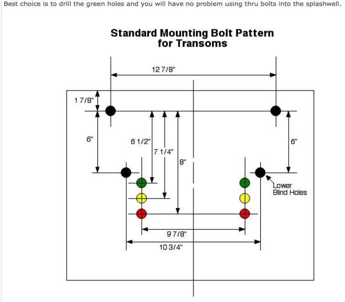

I know it should only be an 1" above the keep
Actually, for an E-TEC on a whaler that is not true. Member testing has shown E-TEC's prefer to be mounted 2 or even 3 holes up depending on the prop you choose.
Drill the GREEN holes.
- EngineDrillHoleTemplate2.jpg (55.43 KiB) Viewed 47989 times
Re: 1984 15' Sport ETEC 60HO Mount opinion
Thanks Phil! So it sounds like use the black holes, mount it up on 2/3 and drill the bottom and then adjust as needed. I have been concerned with the cavitation, but it sounds like with the ETEC, people have had luck putting the motor up higher.
Phil T wrote:I know it should only be an 1" above the keep
So I did measure the holes (black holes at the top) and they are actually 2 1/2" lower. Which puts me lower in the transom to drill the lower holes. Not going to have to much adjustment if I get it just right.

Another fundamental mistake introduced in the discussion by the OP is the notion that the transom holes to be drilled in a Boston Whaler SPORT 15 must be located so that a particular engine mounting height will be obtained, and that one must pre-calculate the mounting height in order to know where to drill holes in the transom. This is not true.
The mounting holes drilled in the transom are located in a standard position, particularly the upper pair of holes. On older Boston Whaler boats with a shallow engine splash well the standard location for the pair of lower holes can be a problem, as holes in the standard position will emerge on the inboard side of the transom below the bottom of the splash well.
The FAQ carefully and concisely explains this problem in detail, specifically for Boston Whaler boats. I pointed the OP to this information, but he dismissed it as having little value for him and described it as “general” information. My inference is the OP did not read the FAQ, or if the OP did read the FAQ he failed to understand the specificity of the information and its precise applicability to his questions about engine mounting.
Once the transom holes are drilled and in the standard position, the engine mounting height can then be adjusted over a range of several inches—which is much preferred to drilling mounting holes in non-standard locations which will prevent any further adjustment of engine mounting height. This is exactly the problem with the OP and his boat: the blind mounting holes were used, and they eliminated further height adjustments.
As explained clearly in the FAQ in regard to selecting the fifth option—the best option, the one recommended by Boston Whaler, and the one recommended in the FAQ—raising the pair of lower holes by 0.75 or 1.5 inches WILL cause a constraint on engine mounting height; the engine will have a minimum mounting height of one-hole-up or two-holes-up, accordingly. But this minimum mounting height of one-hole-up won’t be a problem; that height is generally the starting point for modern engines and modern propellers. Being limited to a minimum of two-holes-up might be a problem in some instances with some propellers, and I recommend locating the lower pair of holes—if possible—only raised 0.75-inch higher than standard.

In the proposed method the engine mounting bracket is being used as a template for drilling the lower pair of holes. This is certainly one method to locate the holes, but it’s a bit awkward. See the FAQ (previously linked) for the dimensions, which will allow you to layout the holes, or borrow or rent an actual template from an engine dealer-installer.
If the engine is mounted as high as possible as proposed, and the lower holes or slots are used to drill the lower hole pair as proposed, the result will be the vertical spacing will be the standard spacing, and that results in the lower holes exiting on the onboard side on the transom under the splash well. Again, see the FAQ for advice on how to solve the problem.
Re: 1984 Sport 15; E-TEC 60 H.O. Mount Height
A pinned topic in this forum further discusses engine mounting height, see:
viewtopic.php?f=7&t=739
All recommendations in that article are applicable to answer the questions raised here and should be read carefully.

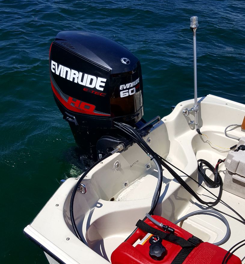

Installed the E-TEC 60 H.O., and it is working great with a 15-pitch propeller: hits about 42-MPH. And no worries about the weight. The SUPER SPORT 15 ran fine. There is a little bow rise when you start, but no porpoising at all.
Motor looks great ! Glad it worked out so well !
Based on the image (above) the engine looks like it has been mounted two-holes-up. The mounting holes appear to have been placed as recommended in the FAQ, that is, the lower set of holes has been placed with reduced spacing so the inboard ends of the fasteners come out of the transom above the bottom of the splash well.
There appears to be some rather minor amount of water in the splash well, indicating the splash well drains are partially submerged. I assume the image was taken with no one in the boat. I would expect that when there is a helmsman in the boat the hull will settle a bit further into the water, and the splash well drains may become even lower, letting more water into the splash well. The position of the splash well drains relative to the static water line at the transom is a good indication of how appropriate the engine weight is for the boat.
The top speed reported of 42-MPH sounds good. My c.1976 SPORT 15 with an old Mercury 500 two-stroke-power-cycle engine without power tilt and trim (and thus rather light) would top-out about 34-MPH. Clearly the E-TEC 60 H.O. is producing more than just 10-HP greater than my old "50" was.
Assessing the performance with the Crouch method, if my c.1976 with a 50-HP could hit 34-MPH, then to hit 42-MPH would suggest the power needed would be 76-HP. The general feeling about the E-TEC 60 H.O. engine is that it is really an E-TEC 75 with a decal that says "60" so it can be used on boats with maximum power ratings of only 60-HP.
A good friend has installed an E-TEC 60 H.O. on his MISCHIEF 15, and it, too, seems very "peppy" even with four adults aboard.
I also like the three-cylinder E-TEC 60 H.O. in preference to the two-cylinder version rated 60-HP. The two cylinder engines don't seem to run as smoothly as the three-cylinder ones. A three-cylinder in-line two-stroke engine seems like a classic configuration.
Tomme -
Because we care about your significant investment in your boat, the following is offered as constructive advice.
Double check the grey fuel line. There have been many many problems with the inner lining degrading and debris entering the engine. I would select Trident or other named brand that is rated alcohol resistant and not grey in color.
Why is there a splice in the fuel line? If a professional did that, that is a sign of half assed work you are paying $80+/hr for. I would take it back and have them run one complete section from inside the engine to the fuel tank. It only takes 15 minutes to do properly. IF a DIY, lesson learned.
To protect the harness and wiring and give the rigging a clean look, consider either wire loom, slit bilge hose (white or black) or zippered fabric rigging cover. There are several diameters available.

Judging by the water in the splashwell in the picture above, I think the static trim on my boat is very similar. (due to the added weight in my boat)
