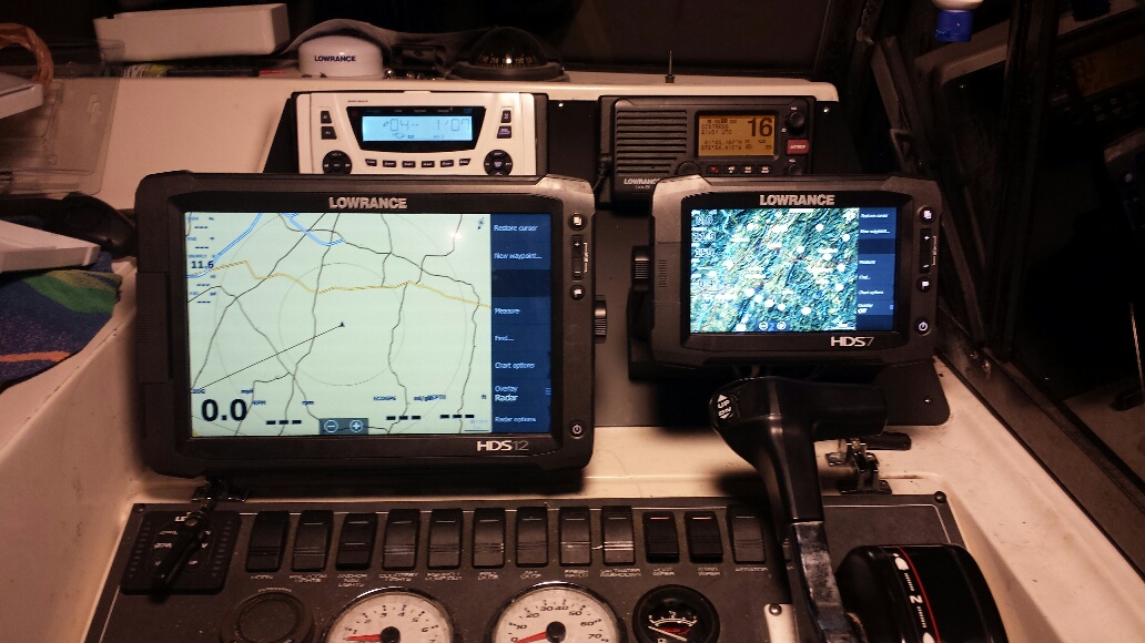

Flush Mount
I like the ability for flush mounting with the unit being attached from the front. Remove the trim bezel and four screws and the unit can be removed from the boat. This could be a plus (or minus) depending on where you keep your boat though.
Interface to Radio

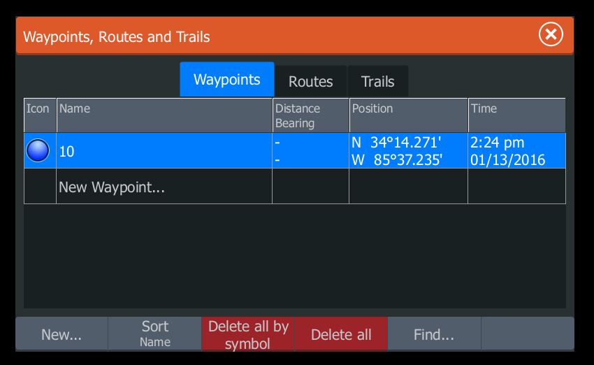

Re: NMEA-0183 Waypoint Transfer
I asked Lowrance about waypoint transfer via NMEA-0183: "Is the HDS 7 Gen 3 capable of receiving and displaying latitude and longitude data in the form of waypoints from another device? Specifically what I would like to do is have waypoints from my Northstar 952 GPS transmit and be usable on my HDS 7."
Lowrance answered: "The NMEA-0183 only shares GPS information, no waypoint sharing."

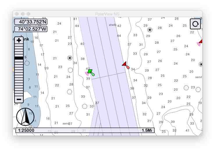

Re: AIS AtoN Target Display
PORTHOLE's comment on AIS target display: "Listed on the HDS vessel display were all of the Ambrose Channel ATONs in the New York Harbor approach."
That is very interesting. I was curious about the ability of the NAVICO chart plotters to display AIS Aid-To-Navigation targets. Perhaps you could take a screen capture of the chart display when it is showing an AIS AtoN target. I would very much like to see how the AIS AtoN target is displayed on the electronic chart of a NAVICO chart plotter.

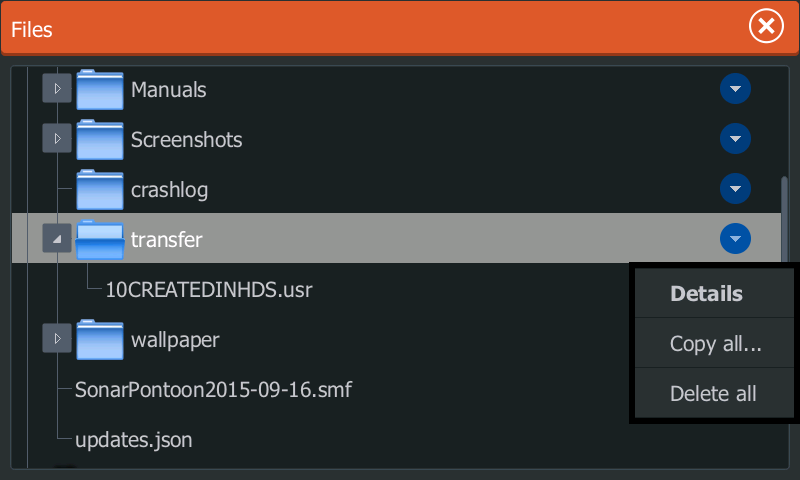

Re: FTP via WiFi
Lowrance GEN 3 device have a WiFi base unit included, and, apparently--I have not tried this myself--they also have a FTP server built into the device. This means that one can wirelessly connect to the GEN 3 device and use the FTP protocol to transfer files between the GEN 3 FTP host and a connected FTP client.
I have not seen this in action, as I don't have a GEN 3 device. There was a thread about this recently on another website. (That site seems to be off-line at the moment or I'd look up the thread and point to it.) This could be a very interesting option for moving files between a Lowrance GEN 3 device and a computer terminal. For example, instead of having to use the sneaker-net approach of writing files onto a removable memory card and carrying them from the GEN 3 device to your computer, you could just retrieve the files from the GEN 3 device via wireless connection and FTP. This could be such a cool feature that it is almost worth the cost of getting a GEN 3 (for me) just to play with it.
The FTP server is at the ip-address of the WiFi base, which is usually 192.168.1.1. You can connect to the FTP server with a typical ftp client of your choice. Once connected, the file directory includes the two memory slot cards and the internal memory of the GEN 3 device. There was some dispute about the ability to write files onto the FTP server; this apparently seems to change with the version of firmware on the GEN 3 device. In any case, it seems like you can always read files from the server. There was also some dispute about whether any credentials were needed to connect. It seems like that might vary with the firmware version, too. I'd be interested to hear more about the FTP server on a Lowrance GEN 3 from users that have one.
jimh wrote:PORTHOLE's comment on AIS target display: "Listed on the HDS vessel display were all of the Ambrose Channel ATONs in the New York Harbor approach."
I forgot to take pics when I was trying it out, but will do, perhaps today. The max range on my GX-2200 screen is 15 miles, so the ATON's if they would show up on the radio were out of range.
Yesterday I had the boat out.
There were several tug and tows that were within range.
I found the CPA and TCPA alarms annoying to the point of turning them off on the radio. Clearing the alarms only resulted in the alarm sounding again within a 30-60 seconds. With the radio in an overhead cabinet the display is difficult to see when you need to use the bottom of your glasses to see.
The HDS displayed the AIS targets when I was zoomed into a level that the targets were within, meaning when the tug came within 1/2 mile of my location it was displayed on the 1 mile range of the HDS (guessing to the exact ranges).
The HDS gave a proper alarm notification on the screen when the target was within my 2000' or 3 minute CPA settings.

On the NOAA ENC chart, the green can is indicated as having a fog signal, a gong. Here is how the official NOAA ENC chart US5NY19M appears for that same location:
The chart was rendered in POLARVIEW NS, a very nice chart plotter application, and, by the way, available for the MacOS. (I saved the screen capture as a lo-quality JPEG, and that's why it is a little fuzzy.)
I never noticed those magenta radiating lines before, but now that you mention they represent a fog signal or gong, I see them on many floating aids, even the one in front of my house!
I guess the indication of having an AIS signal associated with the aid is just the magenta circle around it. It seems NAVICO forgot the "AIS" legend that is recommended.

This is what I've been working on. I originally had the displays flush-mounted, but the 45 degree angle of the dash plus the long reach made it difficult to work with the touch screens. I also made mounting pods to mount the stereo and VHF radio farther forward and tipped them forward 30 degrees so you could see them. The older boats just weren't built to house today's modern large screen electronics.
- image.jpeg (226.22 KiB) Viewed 130711 times

Like porthole, I've been testing the HDS built-in HTTPD Server, but with a Gen 2 Touch; I also have a Gen 3 but haven't tested with it yet. Here is my feedback on using the HDS FTP and HTTPD interfaces:
CONNECTING
For those who may not have read the earlier posts, if you open a windows browser and type in the IP address of your network-connected HDS unit, you get a screen of file transfer options. You can use these options to transfer files to your PC over the network instead of having to use SD cards. I can't find this functionality documented anywhere so I'm just exploring. So far, I haven't hurt anything in my HDS but I don't expect to get any help or sympathy from Lowrance Tech support if things go south.
DOWNLOAD USR
The "Download USR file" option seems handy since it not only downloads the file, but automatically initiates the export on the HDS. In other words, you don't have to press any buttons on the HDS to get the export to happen. A bit of a bummer: the USR export file is created as Version 5 and there's no way to tell it you want anything different, like, say, version 3 or 4.
UPLOAD USR
The "Upload USR" is not quite as automated. When you Upload a file, a prompt appears on the HDS telling you that "A new User Data file has been uploaded to the local device" and asks if you want to Import it. The choices are YES, DELETE, and NO. So you have to interact with the HDS device buttons. But my testing shows a bug. A waypoint uploaded this way can be corrupted as it imports to the device's internal waypoint repository (I don't know if I should call it a database.). I'll post screen shots so you can see the corruption.
The upload function doesn't seem to care if the USR being sent to the HDS is version 4 or 5 (and the same corruption can appear with either version). Also, the waypoint corruption was not obvious to me at first. I uploaded and downloaded hundreds of waypoints at a time, from InsightPlanner, ExpertGPS, NavigationPlanner and other sources, before I noticed that some were being corrupted or simply not loaded. I think it may be some kind of End-of-file or buffer problem, as the affected waypoints are always near the end of the file being loaded. Also, the web upload is pretty quirky about not letting me re-load the same filename back to the HDS device. I'm not sure what's going on with that, whether it's the device, web interface, or operator-error.

I found the quirk with not being able to re-upload the same filename into my HDS Gen2 Touch using the HTTPD interface. It's Operator Error along with an Undocumented Feature.
When a USR file of Waypoints/Routes/Trails is imported from the SD card then the HDS internal database is directly updated. But when the HTTPD interface is used to "Upload from USR" the file being uploaded is first saved in the HDS's internal memory before it's loaded to the database. So the just-uploaded file is now resident on the device. If you try to re-upload the same file, the HTTPD interface will let you and reports "Upload successful". But the HDS device apparently just silently discards the request to receive an already-resident file.
The location of newly uploaded files is within the folder Files-My Files->transfer. SELECTING the transfer folder will let you see it's contents, and you can delete individual files. Pressing the DownArrow to the right of the transfer text gives you choices to Delete (or Copy) all previously uploaded files. See screen shot. After a file is deleted from this folder you can re-upload the same filename to the device.
My testing shows that the HDS device looks beyond just the filename (perhaps at file size too) when determining if the file being uploaded IS the same as a resident file. Files with the same name but differing in content WILL upload. So you could say it was Operator Error to do a needless re-load. BUT if you have separate files for different lakes, and load the HDS with waypoints and routes for only where you intend to fish, then you would run into the same-file problem when you attempt to reload a lake's file IF it were unchanged from the last time you used it on the device.
(BTW: The "transfer" folder is not the same as the internal folder "Files->Transfers (0/0). I'm pretty sure that the similarly named "Transfers" folder is used for transfers between the device and Navico (firmware updates, InsightGenesis, GoFree). The (0/0) by the folder name changes with the number of files there.)
Since files uploaded with the HTTPD interface will accumulate here it's good to know where to clean house if necessary. So now the Feature is unofficially documented.

ASIDE to both PORTHOLE and ACSEATSRI: thank for posting your helm photos. You both have very cool helm stations.

Jimh- Thank you for the compliment. It's the third try after the first 2 layouts were a failure in my mind.
Porthole- the radar overlay on the chart (if you have a heading sensor or Point 1) is fine on a 7" display as long as the display isn't too away. I often DON'T overlay the radar when running at night, instead opting to split the display, running the chart at a low zoom range and zooming in the radar to a separate 1/4 mile range to pick up lobster buoys and high fliers when running offshore. If you do want to overlay, the chart zoom always coincides with the radar. It's pretty cool to look at above-water rocks on the chart and see the rocks "painted" by the radar exactly on the chart. This tells me that the range and heading sensor are both dead on.
But if you can afford more, bigger is always better.:)

The HDS Gen3 (and other Lowrance/Simrad chartplotters) include FTP, HTTP, NMEA-0183 streaming over TCP and also a websocket interface that allows you to get access to GPS, sonar data (depth, etc), standard sensors on the N2K network, alarms and AIS (if available) - kind of a predecessor of Signal-K. There's also a service discovery protocol if you have more than one chartplotter on the network.
I really like how Lowrance/Simrad are making this functionality available to outside developers. As far as I can tell they're the only major manufacturer doing this, all the others are still keeping everything secret.

fixer01 wrote:...The HDS Gen3 (and other Lowrance/Simrad chartplotters) include FTP, HTTP, NMEA-0183 streaming over TCP and also a websocket interface that allows you to get access to GPS, sonar data (depth, etc), standard sensors on the N2K network, alarms and AIS (if available) - kind of a predecessor of Signal-K. There's also a service discovery protocol if you have more than one chartplotter on the network.
All that data! It would almost be worth it for me to get a new HDS Gen-3 chart plotter just so I could mess around with it on the bench with it attached to an Ethernet TCP-IP network. That ought to be enough fun to get through a winter of no boating.

Re: Lowrance HDS Gen3: Installation, Interfacing Tips, and Use
In order to take full advantage of networking multiple HDS Gen3 displays, they need to be connected to a NMEA 2000 network and with a Lowrance specific ethernet cable that is to be connected between the two units.
Two Gen3 MFD's networked. There are quite a few items that are not shared between the two, but there is also quite a few items that are, including a one device screen brightness adjustment that is mimicked on the 2nd device.
Waypoints. Haven't figured out why yet, but the waypoints are not automatically going from one unit to the other (or displayed if that is actually what is going on).
When I first connected the two units with an ethernet cable and the N2K grid, HDS #2 displayed the waypoints and routes from HDS #1.
The other night I entered maybe a dozen waypoints from the comfort of my kitchen using my iPad.
HDS #2 does not display any of the new waypoints.
I also do not get navigation info displayed from one unit to the other.
As another experiment, I set HDS #2's GPS source to the internal antenna. Accuracy level was about 9.5' on HDS #1 while it jumped to 29' on HDS #2.
More GoFree info from Navico
