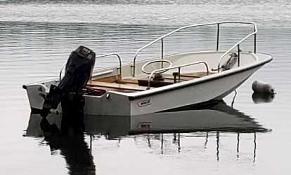

I own a 1978 15 Sport. I plan to refurbish the boat in Winter 2020-2021.
1978 SPORT 15
The boat interior is full of small holes. I assume the core is saturated, so lots of work ahead of me. My problem is I don't even know where to start. Steer me in the right direction.
Here is what I hope to do:
  • Rip out side console and rebuilt, new steering wheel and new instrument panel, all new mahogany
  • Remove old aft bench seat and add bench seat with back rest and under storage
  • Replace forward hatch cover with new mahogany
  • Pull off all stanchions and safety rails, re-bed and replace originals back on to boat
  • Drain water from boat and fill holes with thickened epoxy
  • Refinish and repaint interior
Steer me to a similar project that is documented here. Thanks

[The boat seen in Figure 1] seem to float well. The engine appears to be an OMC 40 or 50. They weigh about 230-lbs.
Little holes for battery boxes and the like will get some water in them. The water usually doesn't go far.

Regarding your plans, I offer these comments:
The wood used by Boston Whaler is very high quality. Usually there is no need to completely replace the wood unless it is in horrible condition. Cleaning, sanding, and refinishing the wood can usually restore the wood to its original appearance.
There is no basis to "assume" than a 1978 Boston Whaler boat will have a interior foam core that is water saturated. I also doubt that a reasonable assessment can be made from the small image of the hull at an unusual angle as seen in Figure 1 above.
For advice on determining if a Boston Whaler boat has water in the interior, see the FAQ.

The inference I take from Figure 1 is the boat under discussion has been left in the water on a mooring at some point. Boston Whaler boats left in the water for more than a few days at a time need to have their hulls protected with a barrier coat and an anti-fouling coat. The owner's manual gives specific advice on this. If you do not have the printed owner's manual, I have created an on-line version of the owner's manual. This resource is in the REFERENCE section of the WHALER section. Visit
http://continuouswave.com/whaler/reference/manual9-17/
to begin browsing the on-line manual. The portion of the manual discussing bottom paint can be found at
http://continuouswave.com/whaler/refere ... tml#bottom
If the hull was not protected with a two-part epoxy undercoat as recommended by Boston Whaler, the hull gel coat may have osmotic blistering and water may have soaked into the hull. The degree to which this occurs depends on the duration of the immersion in the water without a barrier coat and the water temperature.
Another inference taken from Figure 1 is the boat under discussion was left uncovered. This means that rain water could collect in the boat. The SPORT 15 boat can be left with the cockpit sump drain open, and rain water will drain to the sea. The water level in the stern cockpit sump with the drain open should not rise above the top of the sump and should not flood the cockpit. However, if the stern cockpit sump drain is closed, water will accumulate in the stern. This is a further concern for ingress of water into the foam interior via unsealed unused fastener holes in the stern. A rainfall of an inch or two will accumulate enough water to begin flooding the aft cockpit.
Another influence from lack of a cover will be the exposure of the cockpit gel coat to continual sunlight and ultra-violet radiation. The gelcoat will be harmed by such exposure. The rate of damage will vary with the latitude at which the boat was kept. If the boat was from the tropics, sunlight damage is a big concern. If the boat came from northern Michigan or Wisconsin or Minnesota, strong sunlight is only an eight-week phenomenon, and the gel coat won't be as damaged as might occur elsewhere.
