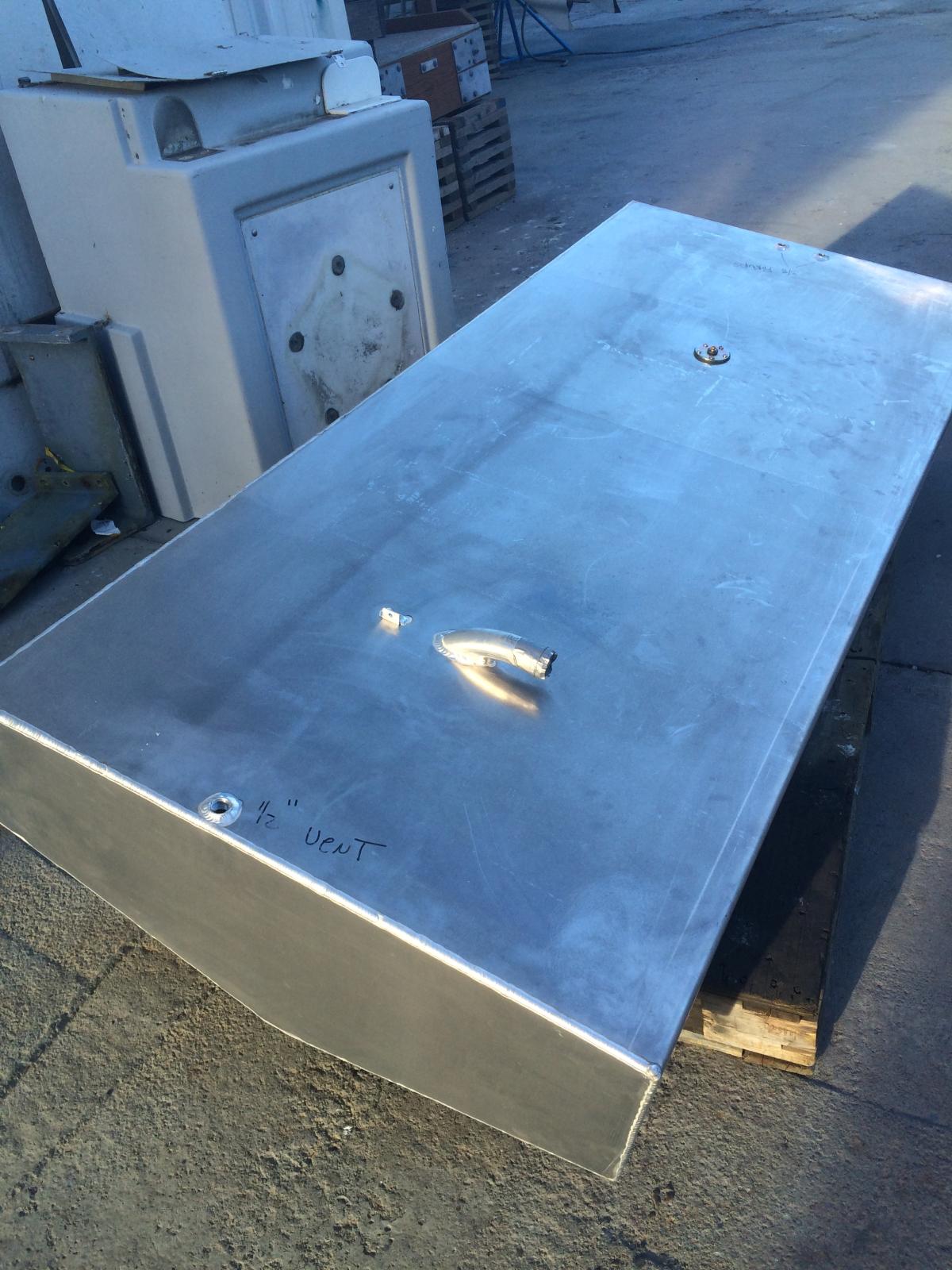

Postby peteinsf » Fri Sep 02, 2016 11:31 am
New tank arrives...
