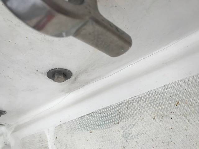

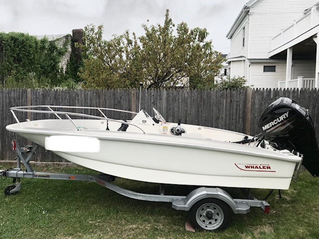

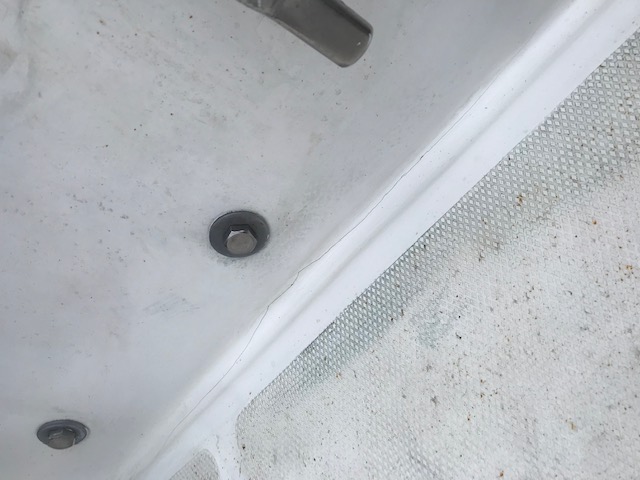

I am the original owner of a 2018 Super Sport 130. Towards the end of the second season of ownership (last summer), the transom had a hairline crack (inside of the boat-under the motor). I have attached a few pictures.
I brought it in and Whaler paid for the fix. Second time out this season (2020), it appeared again. Not the same crack, but in the same place. The length of the crack is about 22 inches. It is in for repair again, but I am just looking for some opinions. Because I can't keep it in the garage where I am, I used some Pettit FlexPoxy to seal it. It is holding on after several trips in the Boston Harbor as well as trailering. I don't know if I want the dealer to go digging around in the transom again to glass it just to fail again. And that's even if Whaler "approves" the repair.

I would not repair it myself on a 2018. I would be in contact with Whaler itself and possibly go under the lemon law if it is not fixed correctly. Your resale will suffer greatly if not addressed. There is a 10yr hull warranty.
Re: SUPER SPORT 13 Deck Repair
Gelcoat is a very thin layer applied to the mould first. When applied too thick, extra 1/16th or more) it can crack.
What your photo looks like to me is a stress crack where the gelcoat is too thick from the factory.
Factory defect.
